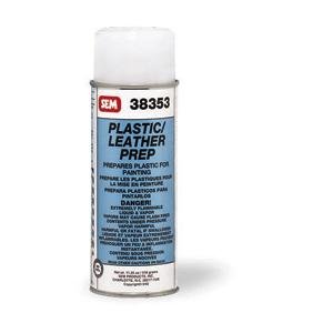

I didn't use any primer, as the 'plastic prep' will remove any marks, fingerprints or oils on the piece after you have cleaned it. I did everything in the early fall and everything still looks great today!

Re: Restoring interior plastic and carpet how-to
So I need to use the SEM adh promotor and then whatever color I want to dye my plastics with? Also, my interior is grey. What is the closest match using the SEM paint? I have a color chart the guy at he paint store gave me but GM 1986' year isnt on the listing.
You don't have to use SEM brand adhesion promoter. I used Bulldog. The paint match in the SEM is tough. I couldn't find something close so I had mine custom mixed in PPG Deltron DBI. It wasn't cheap but they matched it exact. If you can find a color in the SEM, go with it. That paint is good stuff and easy to work with.
ok, I bought the SEM dye, bulldog promoter and the SEM plastic and leather prep. So far, I have painted about 5 pieces and I can tell I am going to be VERY satisfied with the results. The warm gray color was alittle lighter than what I thought it was going to be but I am fine with it since I am redyeing the whole interior. now, I just need to find a CD installation kit that I like and my interior will be well underway other than searching for a few plastics that are broken. I am noticing these car are getting difficult to find where I live.
