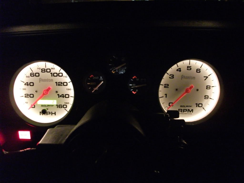

so when i took the camaro out for the first time in the longest time. i recalled how crappy the stock gauges were, so my new project. custom dash to hold autometer gauges. i was looking at the covan's classic dash and it seems silly with the 2 lower gauges, you cannot see them, and i'm not a fan of the smaller 3 3/8" gauges. Jimmy Jams has a dash face similar to covans except the lower gauges are moved outward, still hard to see.
i wanted 5" gauges for the speedometer and tachometer, this limits me on how many gauges i can have in the main dash, so speedometer, tachometer, water temp and fuel gauge, i will be placing the oil pressure and volt gauge in cups under the center vent and removing the autometer 5" monster tach with shift light.
so 3 hours of my work, still in the rough stages...
need to add led's for the blinkers etc.. i'm thinking of using the lower light display thinggy on the original cluster that displays the check engine light etc.. if not, i have led's.
did anyone take a close look at the dashboard? the cluster face is not perfectly straight it sinks down near the speedo... weird.

fiream, i've watched your thread, very nice job. i like the phantom gauges, just not in the camaro, besides i have other sport comp gauges and don't want to replace them all.
robguitargod, i like the carbon fiber look. any reason why you did not replace the other 3 factory gauges? do you have an oil pressure gauge?

i researched the autometer 5" 4 in ones, you need to change every sender, including the fuel level float

the speedometer i'm using is electronic, no cable. my original one was cable, need a dakota digital sgi-5 box to send the signal to the computer and a vss sender in the transmission.

alright, i finished the install i just need to put the gauge wiring under the vents in some black plastic loom. huge improvement over stock
Attached Thumbnails Autometer gauge custom install-gauges3.jpg   Autometer gauge custom install-gauges4.jpg
