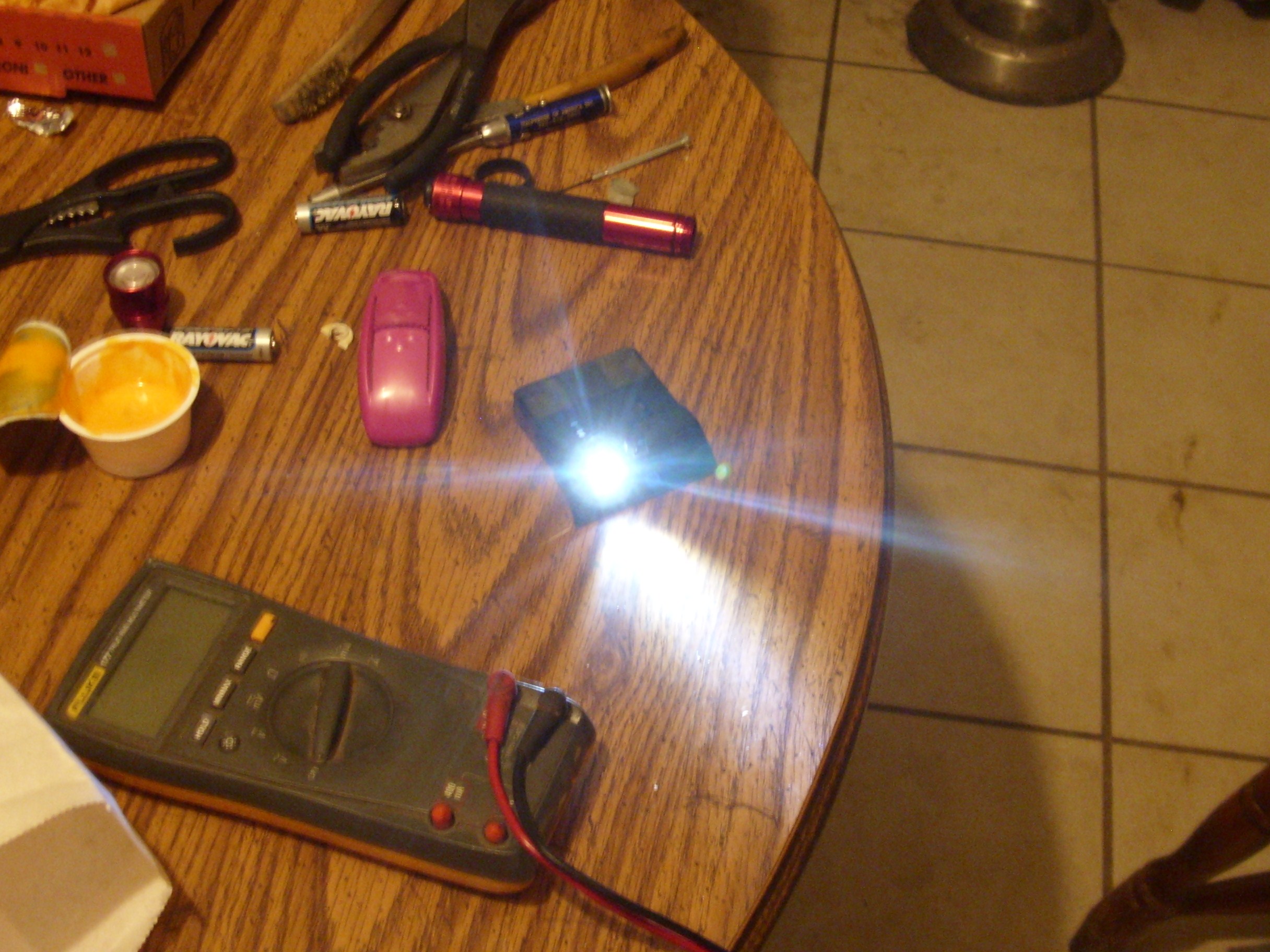

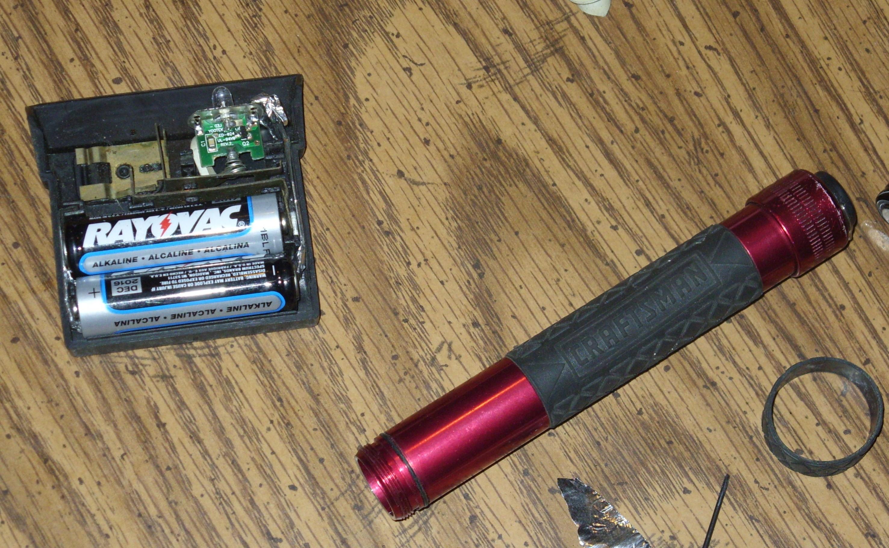

OK, I purchased two over head consoles from Ebay. One was for a T-Top car and had everything (but nothing actually worked). The other was for a hard top but didnt have anything (my car is a HT). I transfered the map light after fixing it and then started on the flashlight and its original light bulb could be saved. I took apart a Craftsman LED flashlight and used it instead and it works perfectly. It still uses almost all the original pieces including the on/off switch.

at one point in time i offered a flash light conversion to member of my other forum. i got no interest so i never pushed it. i took a 15000MCD white LED and soldered it to the correct power points then bent the led leads to fit in the bulb opening of the flash light. still worked the last time i used it.
