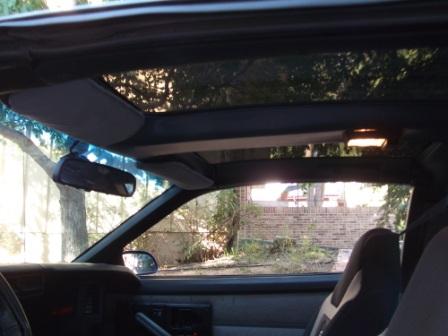

Old Sep 9, 2011 | 11:03 AM
jbird2ooo's Avatar
Joined: Sep 2011
Posts: 5
From: Colorado Springs, CO
Car: 1989 IROC
Re: Started head liner and sail panels
Much better than the old torn and disintegrating headliner.
Old Sep 9, 2011 | 11:39 AM
MAC_87's Avatar
Joined: Jun 2011
Posts: 346
From: Modesto, California
Car: 1987 IROC-Z
Engine: 5.7L
looks nice!
wonder how compromised the structure would be after cutting areas for the overhead console...
Old Sep 9, 2011 | 01:31 PM
LarryL's Avatar
Joined: Nov 2004
Posts: 251
From: Florida
Car: 84 TA,69 camaro,81 vet 92 vet
Engine: 400
Axle/Gears: 3:73
The overhead console will help hold up the headliner. It screws to the roof. When I added one to my TA the holes were there, so no drilling stright bolt in. Just have to connect the wiring for the overhead light.
Old Sep 9, 2011 | 09:17 PM
MAC_87's Avatar
Joined: Jun 2011
Posts: 346
Car: 1987 IROC-Z
Engine: 5.7L
http://www.1aauto.com/1A/headliners/...51/472649/1987
i dont see any holes for the Overhead Console. only the standard dome light.
"All truck and car headliners ship UPS Oversize 1. This product is rolled up in to a box for shipping and must be laid out as soon as you receive it. Please allow 24-48 hours for the headliner to retake its shape before installing."
wtf? - so, would this thing even be able to withstand cutting into or will it shrivel up?
that being said, is there even a company that makes a ttop headliner that includes the overhead console connections pre cut?
Old Sep 9, 2011 | 11:54 PM
LarryL's Avatar
Joined: Nov 2004
Posts: 251
From: Florida
Engine: 400
Axle/Gears: 3:73
There are two screws with no threads close to the screw head, they screw into roof metal. The console slides onto the unthreaded part (in front) and screws on the back of console under the light cover. The front can be a pain to slide in. It must go on first. It took me a while to get them to slide on. You have to push up on console and slide it forward. Look at the top of console you will see the slots.
Old Sep 10, 2011 | 12:19 AM
MAC_87's Avatar
Joined: Jun 2011
Posts: 346
Car: 1987 IROC-Z
Engine: 5.7L
i must be blind, im completely missing what youre pointing out..
there would need to be 3 sections (openings)
in order for it to fit correctly seeing as how its shaped like this:
_|__|__|_
vertical lines being connection points. back part being the actual screws that go thru the dome light section.
per the photo of the headliner it appears there is Only the area for the dome
light...

Old Sep 10, 2011 | 04:31 AM
jbird2ooo's Avatar
Joined: Sep 2011
Posts: 5
Car: 1989 IROC
It comes loosely rolled in a fairly large box and doesn't take more than a few hours to flatten. It's sturdy enough. To enlarge the dome light hole I drilled small holes side by side along the outline I wanted. Then snipped as much as I could. To finish I used a dremmel tool. You just have to be careful not to let the tool slip and I used a block of wood under the drill and a small bit so the bit didn't grab. You can't tell I did the cutting. If you had to cut an area for a console, I'd cut it just so the edges of the cutout would slip under the edge of the console (just like the dome light). That actually holds it up quite nicely.
Old Sep 10, 2011 | 11:32 AM
mattmerritt89's Avatar
Joined: Feb 2007
Posts: 131
From: Flowery Branch,Ga
Car: 1987 Camaro
Axle/Gears: 4.56
That does look good. I think I'm going to order the headliner next Friday. I wish Yearone had them a little cheaper I would just go down and pick one up. I might get one from there just so I can get it in next weekend.
