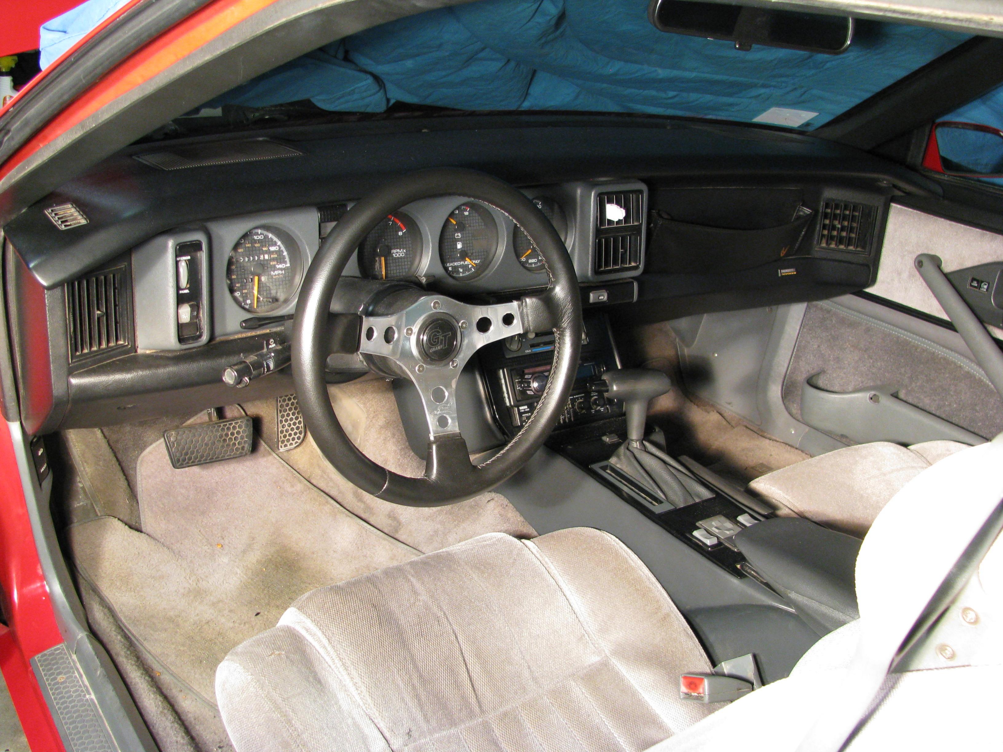

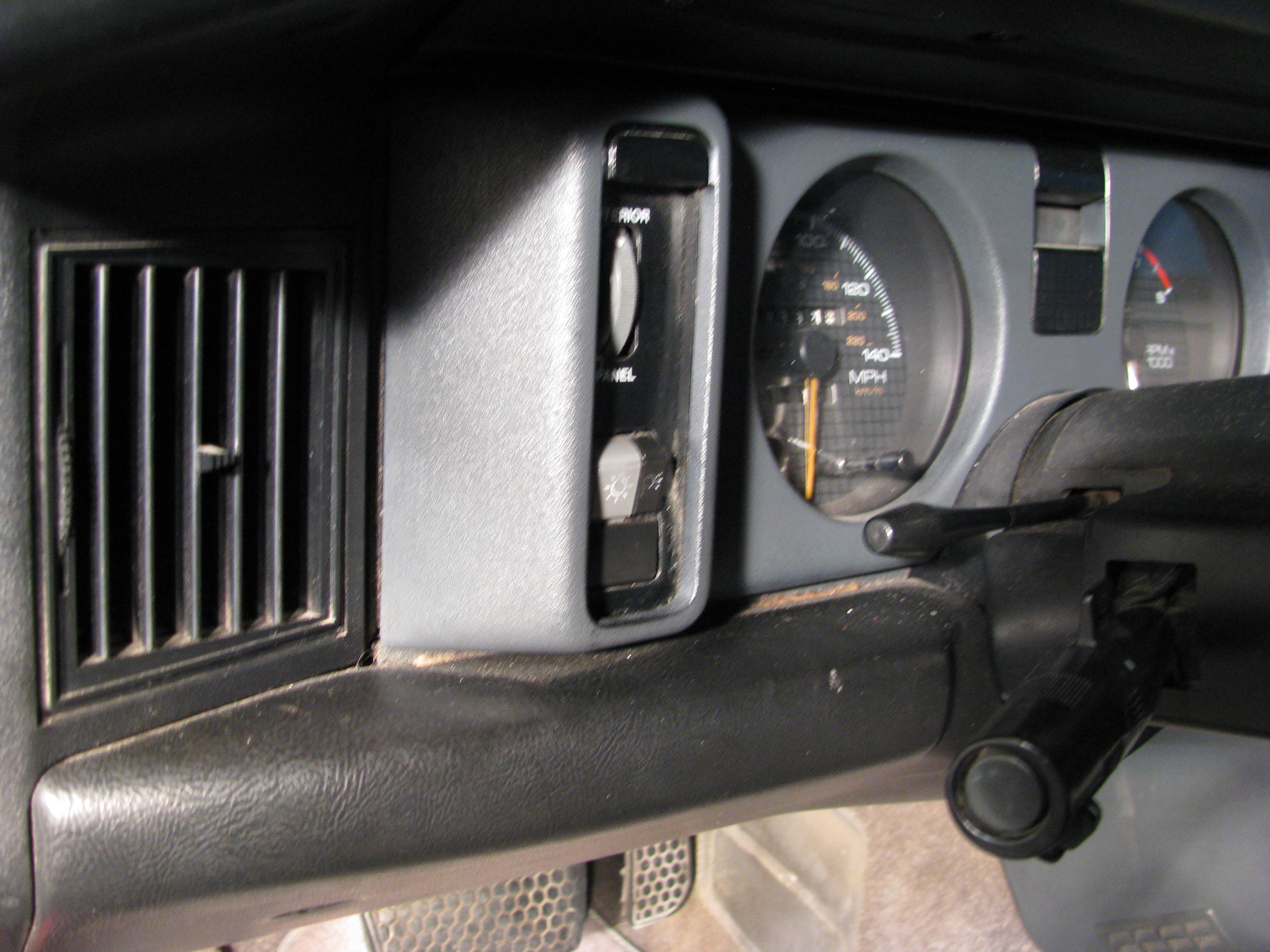

so after spending an hour searching on this site and going out to the garage trying to figure out. Im trying to remove my cluster panel to replace some gauge lights that are burned out and im trying to remove my srs air bag light because i have an aftermarket steering wheel in my firebird. I have some pics of my interior.it seems easy on the pre 90s cars but i can't figure out how to do it on my 91. I need to know step by step where do i start unbolting. any help would be great. thanks.

Not positive, Mine all apart for the cage, but there are screw that go in towards the dash pad, you may have to pull the dash pad to get to them, then you have to take off the pastic thats down by your knees so that you can access the screws for the bottom of the bezel. Once the bexel is off you can pull the cluster out after like 4-6 obvious screws.

The big knee blocker pad under the wheel coes off first. There are recessed bolts under the plastic plugs. They are torx or Allen bolts iirc.
The dash pad then comes off, then you can remove the gauge surround and gauges.

If you look right above the steering column on the bottom of the dash pad, you will notice that some of the screws are for the dash pad. The other screws are for the cluster bezel.

ok so the only problem I'm having right know is taking off the knee panel right below the steering wheel. I see it has 2 torq screws any more. Its not going smooth for me. I need some pics maybe.

no that's what I'm having trouble removing. The panel beneath the steering column is giving me big trouble. Can someone tell me how many bolts are in that knee panel total. Thanks

Camaros have 5, I imagine yours is probably the same. Two on the edges closest to you and three, center, right and left edge on the back end. The two closest ones came with plugs to cover the screws that have to be pried out first. It's also attached with clips that connect it to the piece right behind it that covers the area above your feet.
Just squeeze the back side and they slide right out

thanks everyone for your help. It worked. Thanks again
