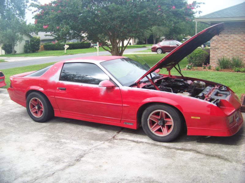

Originally Posted by Cadaver Puncher
Sounds like a plan.
By the way, that red Camaro is exceptionally nice.
The rims really complement the rest of the car.
mine is far from that nice. But I saved it from the crusher. So with a little tlc I'll revive her.
Thank you for the nice words sir!!! Believe it or not, mine was headed for the crusher as well. Here is a pic when I got her:
The previous owner was going to give her up for $50 to the salvage folks. She had NOT cranked in 6 + years.
