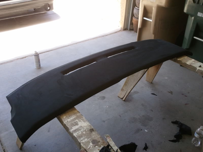

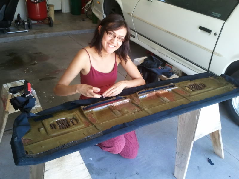

Now onto the supplies. All you need is the fabric and the upholstry spray glue. Got both from Joanns. The micro-suede was about $9 yard, picked up 2 yds but I'm pretty sure 1yd would've been enough. The glue was about $10 a can.
Now onto laying the fabric.
1. Spray down the tops and sides of the dash pad and bottom side of fabric with the glue
2. Lay down the fabric over the pad. (the glue is extremely sticky and dries fast, was unable to take pics for this reason)
3. Stretch fabric tight until whole top/sides of dash are covered (be very,very,very carefull not to get glue on top side of fabric)
4. make multiple slits in fabric over rear vent holes and fold under
5. Now onto the underside, flip over dash (make sure you have clean work surface to lay the dash on)
6. trim away excess material
7. spray underside edges with glue(be very carefull with glue overspray)
8. fold over edges and stick to underside (this part was a bit difficult so my wife helped here, she's a seamstress, she also cut and folded over the rear vents which was also pretty difficult)
btw: just wanted to give special thanks to my wife, we live in Phoenix and it was 111 degrees that day which put it at about 105 in the garage, and she toughed it out to help get this done!!!

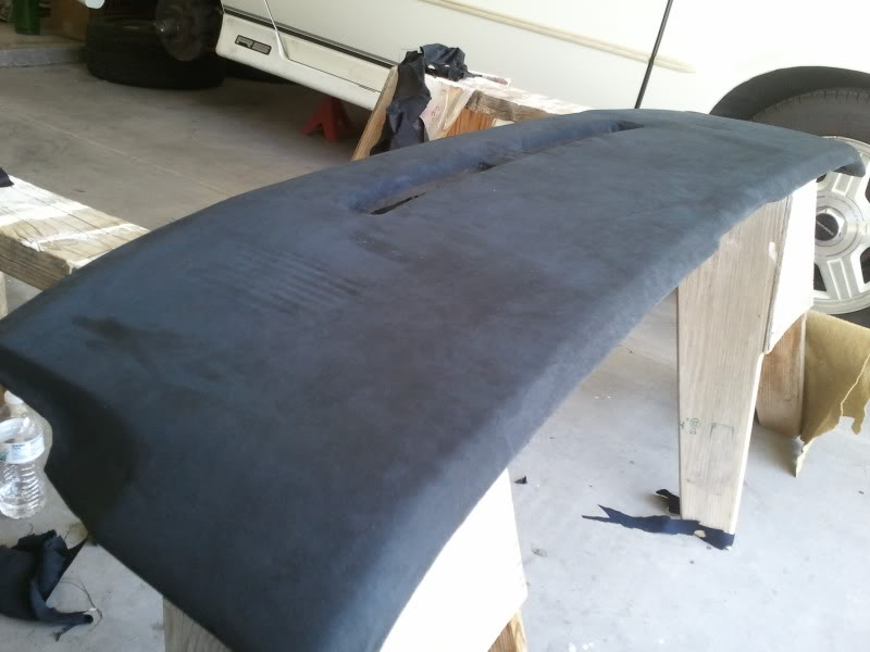

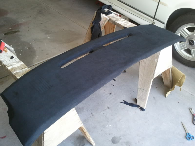

Here's the finished product

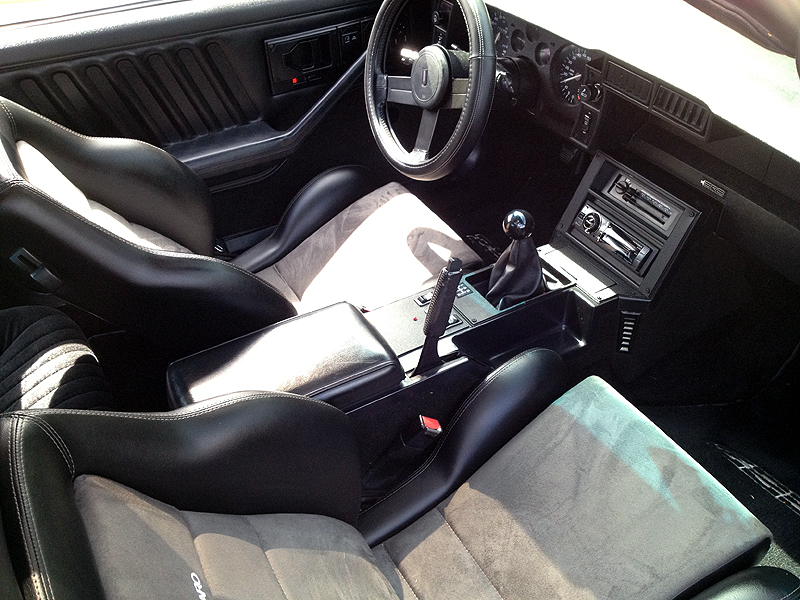

Installed
