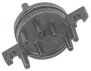

a/c control unit
ive narrowed down my vacuum leak to behind the ac unit. theres a vacuum diafram thats attatched the the ac unit in the back and all the vacuum lines plug into this. question is can i get this at a local parts store? and what exactly is this piece called? because i got a better chance of learning chinese the trying to get a guy at a parts store to know what im talking about.

It's a Vacuum Control Valve . I doubt they have at say Autozone though.
Modern Day Muscle sell the entire control panel for $20.
http://www.moderndaymuscle.com/inc/s...ntrol&n=710919
http://www.rockauto.com/
RockAuto = ACDELCO Part # 1571350

Ringo234 - I'm coming up empty finding one. Rock Auto now says ACDELCO 1571350 not found; ditto on General Motors 16032395. I have hit several GM parts websites all saying 16032395 discontinued. NAPA had a listing of 207708 (a number provided by another Third Gen member on a different thread) but it is no longer available. Advance Auto Parts called Four Seasons who said out of stock and no longer available. When I finish this post, I will start doing searchs on the ACDELCO number you provided, thank you for that. I am reluctant to buy used. I already have one of those. I read in another thread that I can pull out the diaphragm, soak it in brake fluid to make it swell and it will last for a little while longer.
