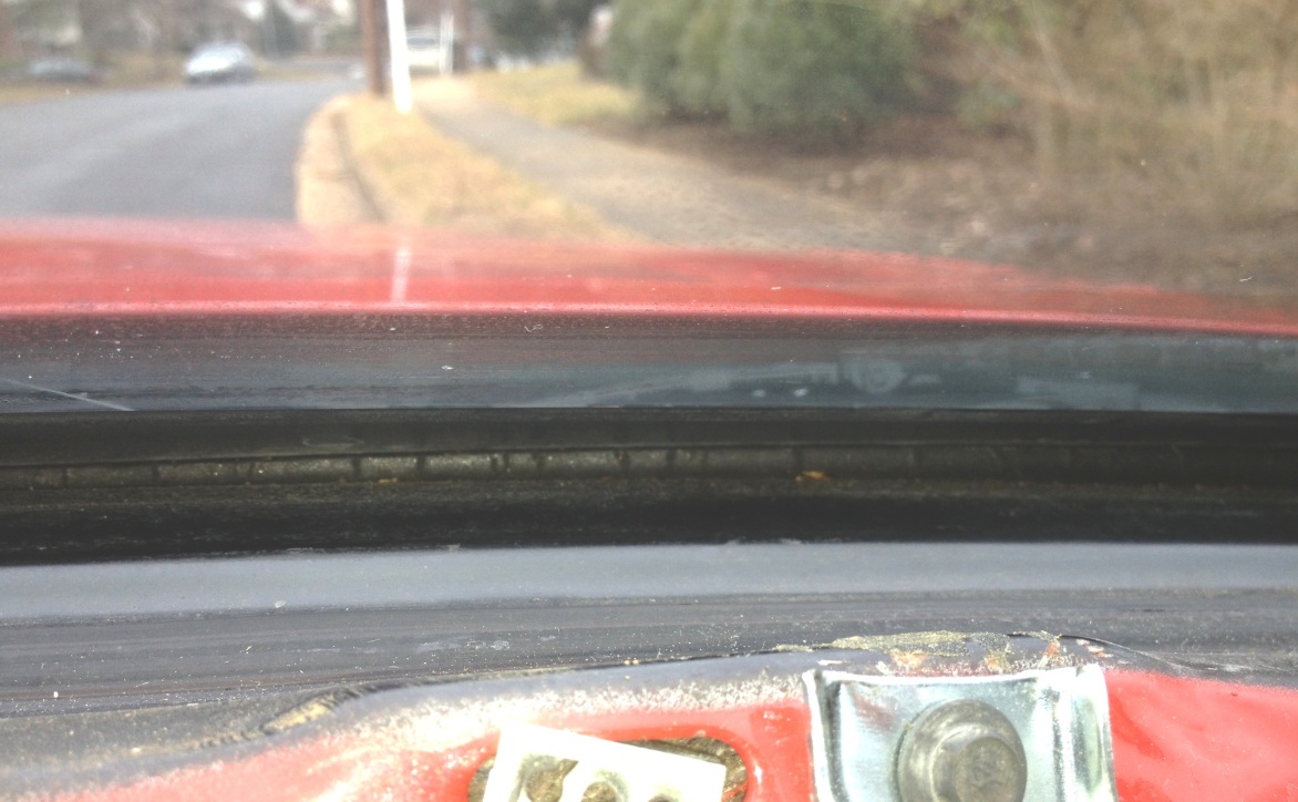

If your windshield has never been replaced, odds are the seal looks like this:
Your windshield needs to come out.
50-50 chance it will break during the process.
Patch all holes, and seal windshield around all edges.
One mistake in re-installation, and it will still leak.
Nobody said this was going to be easy.
