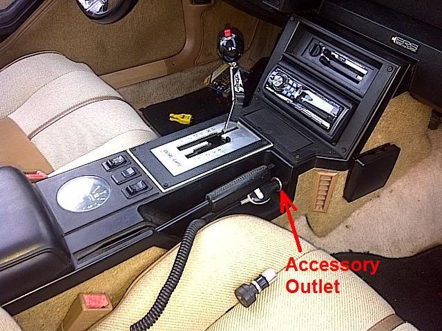

Here is where I added one.... So much easier to get to and looks like it should have been there. NO obstruction! When I don't have anything plugged in, I have an extra factory lighter that I put in there. So I did use an original Camaro lighter setup that came off a defroster panel that I bought.

Oddly enough, I've been considering that very spot (great minds, lol). How'd you make the hole, etc, etc. Any pics or info would be helpful. I assume there's no interference with the ashtray.

That spot works well.... There was something that I wanted to do differently but I truly cannot remember what it was. I have not been in the car since Thanksgiving. I will get in the car this coming week but the ashtray was good, the way I drilled was a small hole saw, I think I use 5/8" but might have gone up to 3/4". I wired directly off fuse panel so it is always on because I had to run a wire for the clock that I added anyway. I did not use my original console top because I did not want to alter in any way. I think if I did it again. I would have moved it slightly off to the left of center (doing this would have made it easier to insert actual lighter assembly, I was VERY close to the edge of the plastic support behind hole, I did not remove console to drill, did it all right in place) and maybe just a tad lower. I used the brake handle as my reference and centered it in the area when the brake handle was at its lowest point.
Tape the location and mark it before removing, Then do it outside the car, should be smoother than what I did.

It doesn't interfere with the ebrake at all? Driving a stick, I use that all the time. I really like that spot.

Nope, not one bit! Fully functional e-brake and lots of room.

...I drilled was a small hole saw, I think I use 5/8" but might have gone up to 3/4".
What kind of bit did you use?
