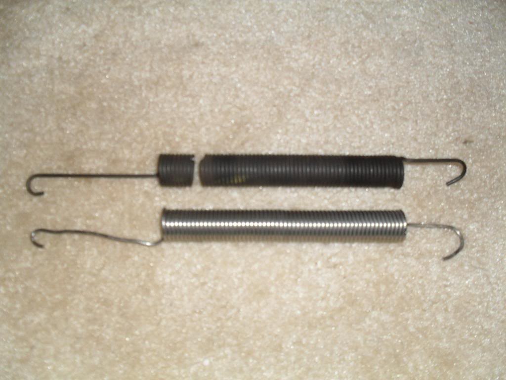

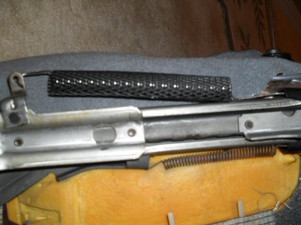

Wanted to update this thread.
I searched around for a while and didn't find anything. I believe it is discontinued from GM.
So I decided to make my own. I order a spring from Mcmaster Carr that I thought had similar specs, length, diameter, wire diameter, etc. The rate seems just a tad stiffer than the stock one. And this one is stainless.
It came with normal loops for the ends. So after a little work using a vice and various pliers, I bent the ends the best I could. It's not pretty by any means, but It's close enough and it seems to be working fine.

That looks real good, you might want to post the part # for that spring in case others would like to try it.

Sure.
94135K38 out of McMaster Carr.
$7.14
I think I ended up trimming the end with the larger hook about .5" after I was done.
