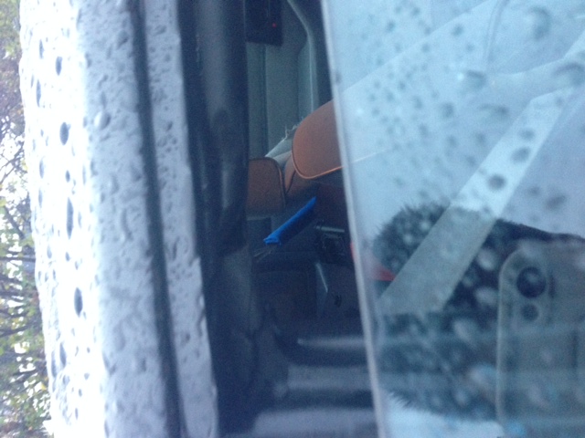

I've purchased a complete T-Top (not C&C version) 1A Auto weather strip kits.
However i'm only having issues with the T TOP WEATHER STRIPPING on the passenger side! This was the Door triangles, complete t top set.
After installation, and proper break in of weather stripping (grease then applying conditioner).
The rubber on my passenger door is literally punctured where the corner of the window closes to the weather stripping.
The front driver side end of the T-Top (top part of weather stripping from door, bottom of t-top glass) is LEAKING RAPIDLY!!
This is not the quality i usually get from 1A Auto products - Not bashing just sharing my experience!
You guys are always very supportive to your customers but now i'm out of the cost of labor not to mention the cost to purchase the weather stripping parts and get it professionally installed.
Since i didn't purchase the weather stripping from the upholstery shop, He can't warranty a product that he didn't supply as well so now im out 500$+ and worse condition of weather stripping than before!! I watched the installation process and the demolding of current weather stripping -- I'm just that type of guy when anyone works/touches my car I observe and ask questions to learn.
Whats an even big bummer is its just one of the weather stripping pieces thats leaking - the passenger t top, not going to risk buying another kit just to use 1 piece of rubber for a 300$ Kit.
I am just sharing my experience and will upload more detailed pictures of where it leaks from, and the BIG (larger than quarter size) hole in the weather stripping as well. This is just on my passenger t top!!
It's been raining over here now in CA San jose and I'm literally cringing with every drop - I will post better pictures of the faulty area's and also of where it leaks. Its not just a drip either, It LEAKS!!
When I Take a turn my passenger/doorpanel/armrest get covered in water!
Please, If anyone can help in any way that would be widely appreciated and words couldn't justify my gratitude!!

It looks like the weatherstripping on the t top is not meeting the body weatherstripping properly.

For the seal to be all damages like that seems like you door is out of alignment. Worn hinge pins and stop.

I've replaced both pins, bushings and retainers in my Camaro and K1500.
Secondly, I agree with the seating of the weather stripping being the biggest area of concern. Prep time is the biggest factor for anything aesthetic on an automobile. Regardless, I'd like to speak to a specific representative honed towards our 82-92 f body make to maybe elaborate any other experiences they can share with there previous consumers.
I will provide pictures but i work 6-6 everyday except sunday so what was in the picture was about as best as i could grab before i went my way to work.
When i received my weather stripping i let it rest in its 'to-be installed' position for a week. Still, I noticed the corner of the mouldings (where the top corner goes down the back of the cabin and meets the end of the door) was still contoured in a position that looked unnatural.
I'm not speculating what 'could of happened' Im simply stating what was going on since i first pulled them out of box.
I took it to an interior upholstery shop that is more then reputable - Family relative owned - I'm not questioning the quality of the product nor the service.
This has been my experience with the weather strip kit, MY EXPERIENCE. everything else that wasn't glued i've installed and has held impeccably. ON BOTH MY VEHICLES.
