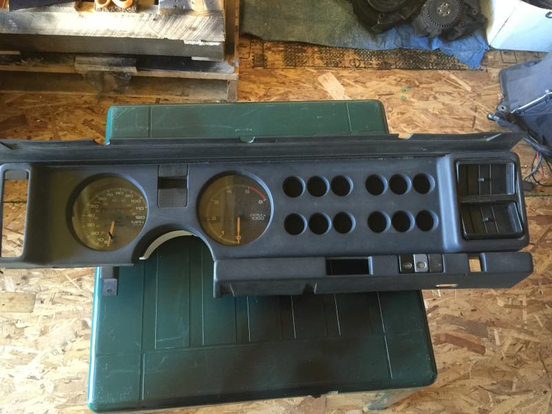

I have never liked the 4 big ovals in the Trans Am pod, and I was browsing eBay and found a bezel with only 2 ovals, but it has a bunch of little ovals cut out.

So, when I place it over my gauges you can see parts of them. Well, easy and cheap fix, I got some fabrics and taped it to the gauges.

And now the after picture.

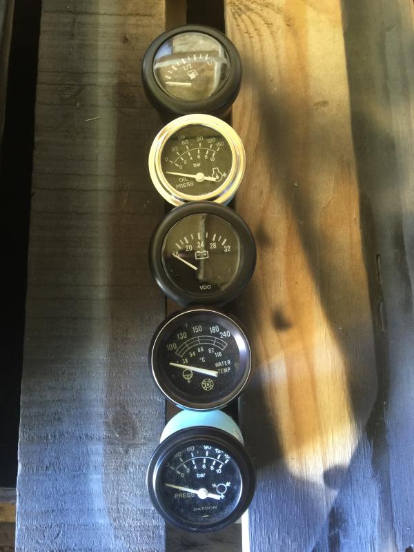

Now, I went and purchased small gauges to replace all the stuff that is covered up. Fuel level, Oil pressure, Battery Voltage, Water Temp, and Air PSI.

Yes, I know one is chrome, I am fixing that. I also, may purchase a Trans temp or some other gauge (suggestions?) to make it an even six.
Now, onto my other issue at hand.. Where to mount the rest?
2 or 3 on the pillar, then 2 or 3 where else? I don't want to drill into the dash pad, but I have seen 2,3,4 gauge pods that I may be able Velcro up their, but then what about running the wires? If I don't get any viable suggestion I may bite bullet and brill through the dash pad...

Originally Posted by NowhereFast
I'd find a way to use the empty space where the holes in the dash are. Seems kind of silly to have all those holes there that serve zero function.
I am open to that, but how would I do it? The gauges are 2 inches deep, no mounting room without drilling into the gauge stock cluster.
1. Scared I could break it or ruin it completely from working on the half I need, MPH/RPM
2. I would want to easily return stock maybe down road?

Try looking for a junkyard, CL cheap gauge cluster.. On the cheap cluster, cut the clear plastic lens right past the tach.. Remove your other gauges or warning lights or what ever from JY cluster.
Grind out some of the holes in your bezel and push your aftermarket gauges through untill the gauge's lip/ring touches.
