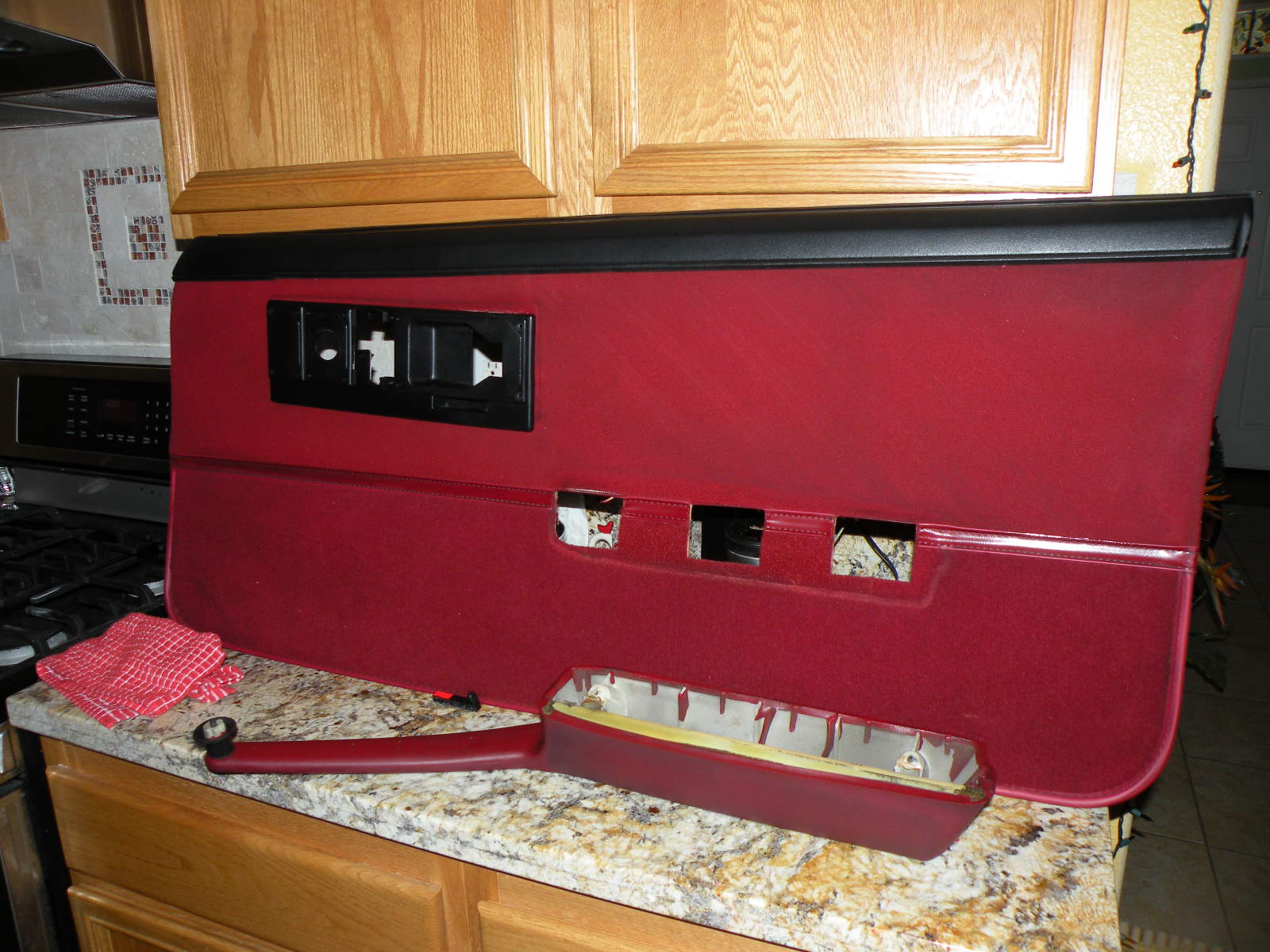

I just refurbished the drivers side door panel and installed new door weatherstripping. The outter door and inner door handles also required replacing as they were broken. This is something I wanted to do for a long time and never got to getting around to it until now. For X-Mas I bought myself some new weather stripping for the door. I already had the unbroken black plastic channel piece from years ago. These had good condition window felts so that was an added bonus to install them. The fabric on the corner was sagging as well and I had bought a can of the Carmine Red carpet paint for a quick touch up on them as well. Some of the tabs were broken but not to worry...creative uses of Gorilla HD tape and some Rhino double stick also paid off. It's not a PERFECT job but it looks 98% better and the door no longer "rattles" as much when going over large pot holes...

more pics of project
P/S I didn't have to cut too much off the head of the new door weather stripping for the door to close. It is still a lot tighter than before but I suspect it will loosen up in a few days of use...

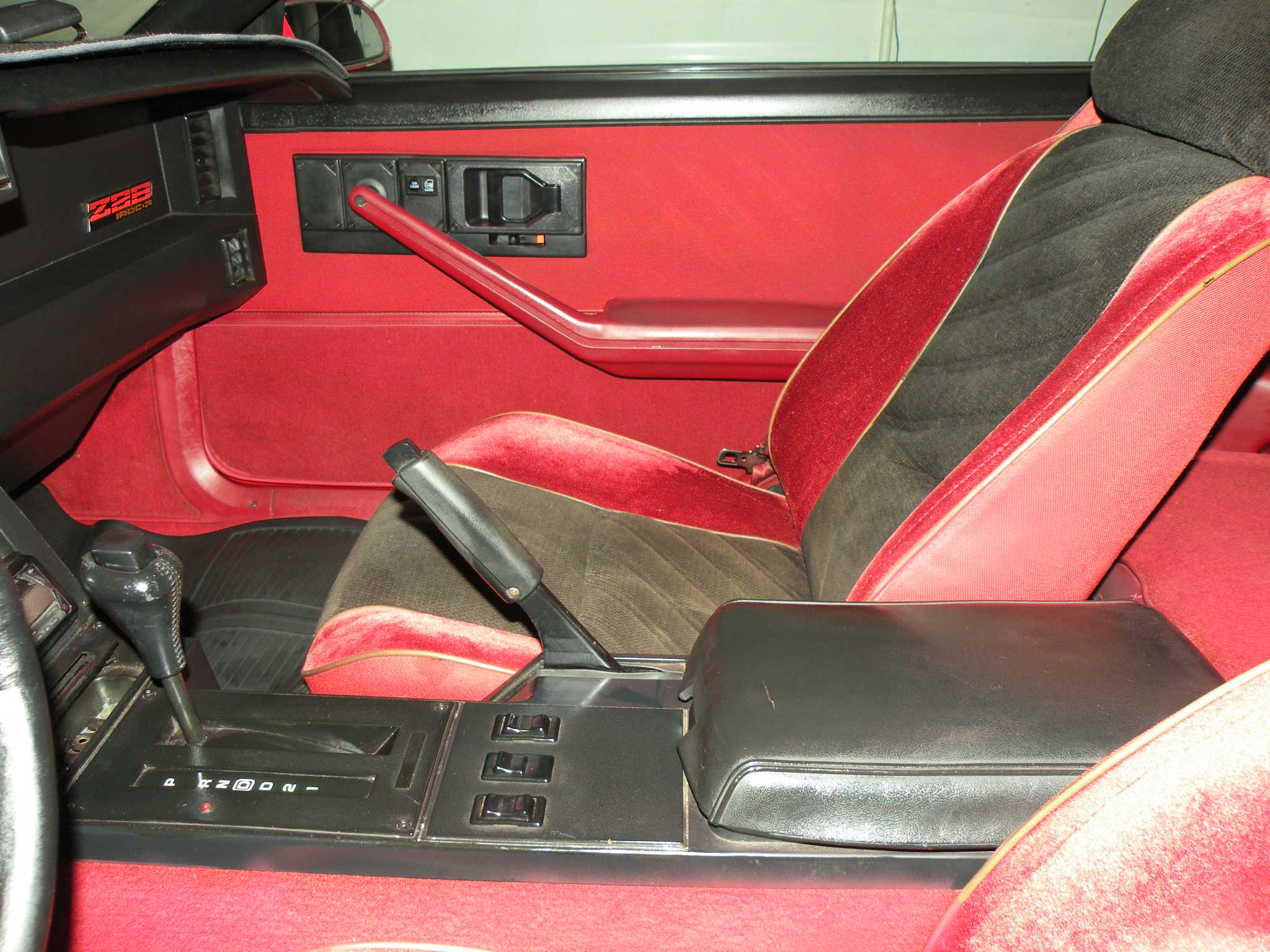

Decided to "touch up" the IROC interior after concluding the Door Panels.
1.) OEM Carmine Red paint touch up carpet, rear hatch, sail panels, and floor boards.
2.) Midnight Black fabric dye to touch up custom 2-tone drivers/passenger seats. In pics.. camera flash drowns out the blackness of the dyed seats.. they really do look great in person..
3.) T-TOP Bag repair... mounting straps sewed back on and bag detailed/mounted.
"CARMINE THE PIMP" RED interior is ready to IROC n ROLL!!!!
Attached Thumbnails 87 IROC Door/Panel Weather stripping Refurbishing-int1.jpg   87 IROC Door/Panel Weather stripping Refurbishing-int2.jpg   87 IROC Door/Panel Weather stripping Refurbishing-int3.jpg   87 IROC Door/Panel Weather stripping Refurbishing-int7.jpg   87 IROC Door/Panel Weather stripping Refurbishing-pass5.jpg

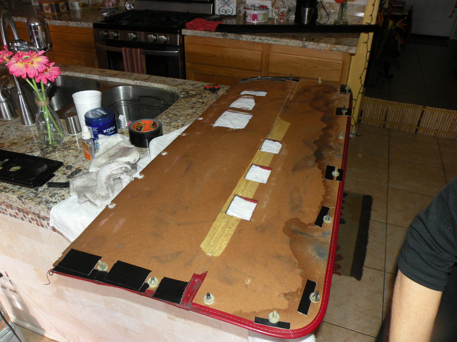

So what's going on in this step / photo?
Old Dec 24, 2014 | 02:43 PM
Zink57's Avatar
Joined: Jul 2004
Posts: 70
From: So Cal
Car: 1987 IROC Z
Engine: LB9
Transmission: 700-4R
Re: 87 IROC Door/Panel Weather stripping Refurbishing
DynoD
That is Rhino double sided adhesive tape to hold down the bulk of the "sagging" cloth on the door panel. I used Gorilla tape and/or a combo of the Rhino and the Gorilla T to anchor the door panel cloth on the outer most corners and along the top channel before mounting the black plastic channel pieces. Like I said...it's not perfect.. but it's functional, looks 98% better and will last. More importantly it's easy to replicate if I have to take off the door panels again to repair a window motor regulator in the future... SIMPLICITY is the key for me. -
