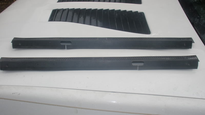

Re: will 4th gen front seatbelts work in 86iroc
You need 1982 bird/maro door sills for this to look right.
Heres an image from a search on here.
