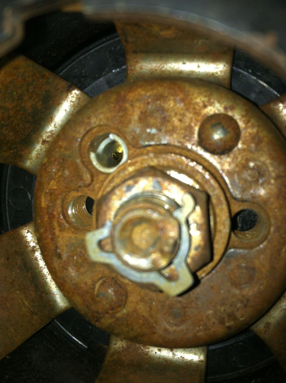

Hello,
I was wondering if anyone knew how i could go about fixing the plastic sleeve that holds the contact for my horn button to work i will post a picture to show

As you can see the small white collar has cracked with age.<br/>Is this removable<br/>

You'll have to replace the cam. See post #9 of the following link for a pic:
https://www.thirdgen.org/forums/elec...orn-fails.html
Useful info/pics:
https://www.thirdgen.org/forums/susp...-steering.html

When I pulled the wheel for my car I found mine was broken but someone had hot glued the wire in, was in pretty tight.

Now can a new reproduction cam be purchased or is that a more junk yard type of piece?

It should still be available in Dorman/Help:
p/n 83232 for tilt wheel:
http://www.dormanproducts.com/p-4057...origin=keyword
or p/n 83233 for non-tilt:
http://www.dormanproducts.com/p-1379...origin=keyword

I just changed my steering wheel and horn button and realized that clip was missing but the horn wire is firmly stuck in the column, the horn button that I took out was a glued together mess so who knows if it will work, guess I'll find out when I get the engine put back in and have a battery again.
