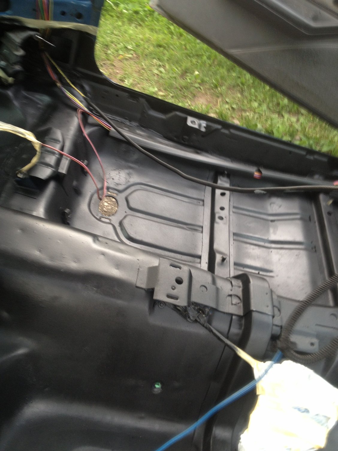

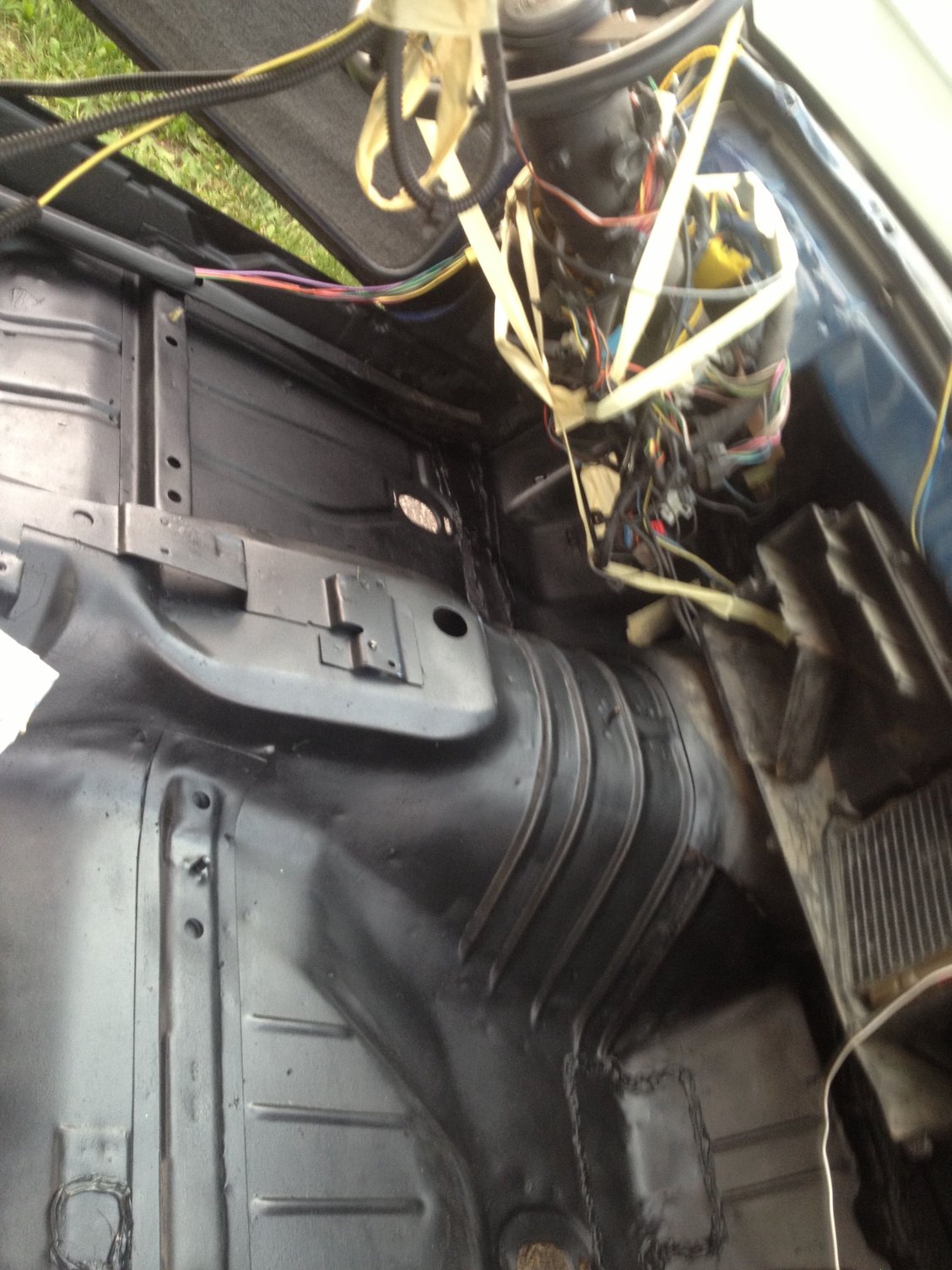

I scuffed with 100 grit put rust killer primer over any bare spots and then Duplicolour truckbed coating. I dumped a can of laquer thinner to thin it out and on it went with a foam roller and I used the spray can for hard to reAch areas. Came out nice I did 2 coats. It's not crazy thick but my floors were in pretty nice condition for a Canadian car it only got driven 2 winters in its life.
