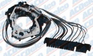

1. yup
2. pretty much, Not 100% sure but you might have to open up the notch where the stock connector for the steering wheel controls fits They are different sizes.
3. not exactly either of the two. The multifunction switch is what the stalk plugs into, its not the cancel cam for the turn signals, its completely seperate. You have to pull the cover on the side of the column, it clips in, but becareful cause if it breaks you have to find a new cover - the source for that is corvette central
4. well the wipers are a completely seperate thing and they are a completely seperate connector and it transfers over when you transfer over the wiper switch.
Igntion and turn signals just plug right in. GM didn't really change much
), but I'm still not clear on what part you mean by the multifunction switch. I was referring to the part in the picture. I last had my column apart in June, and as I recall, the wiper/ts stalk plugged into the switch in the picture. I'm also not sure what part of the column is prone to breakage. I'll have to look, but I can't picture a cover on the side of my column. Is that a 4th-gen thing?
Also, on the 4th gen column, did you leave the SIR wiring in place or can it be removed?
Thanks again. I'm sure it won't be too hard to locate a nice 4th gen column with SWC.
