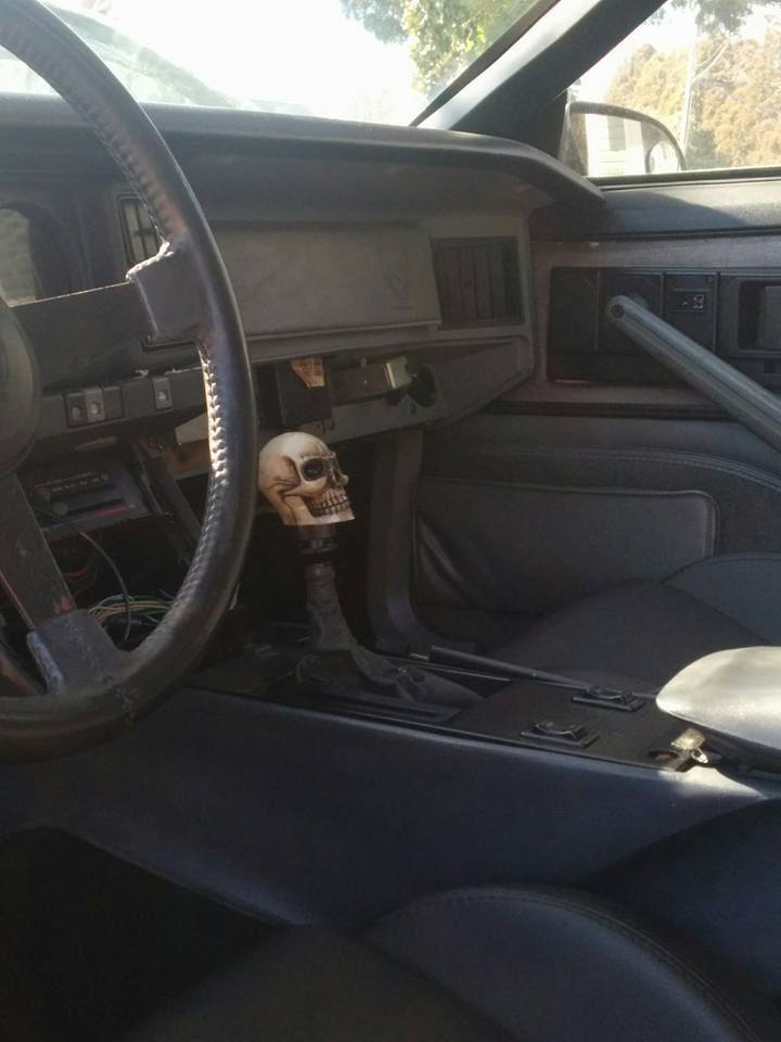

Car: 1985 Firebird S/E
Engine: SBC 350, mild cam Vortec heads
Transmission: Rebuilt 700R4 vette servo+shift kit
Re: Aftermarket Automatic Shift *****
I just disabled the spring that pushes up on the plastic rod which is what your button actuates. With the spring disabled you simply push that plastic rod down then secure your normal aftermarket **** in place. I apologize in advance if you were thinking of something different.
