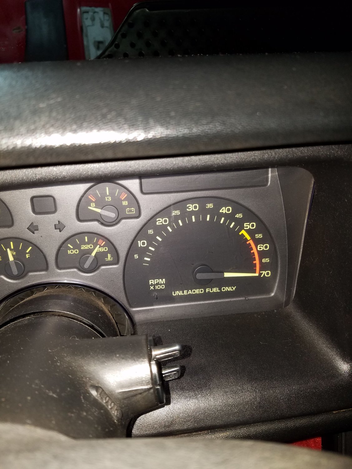

My tach is always like this off and on and never moves I disconnect the battery once then it went down to zero what's happening

Here are some links that might be helpful:
https://www.thirdgen.org/forums/elec...meter-fix.html
https://www.thirdgen.org/forums/elec...o-rs-tach.html

Another victim .... I fixed mine with a 5 cent 96K resistor ....
Just have to pull out the tach circuit board and solder in the resistor. Follow the
instructions on the link provided above.
