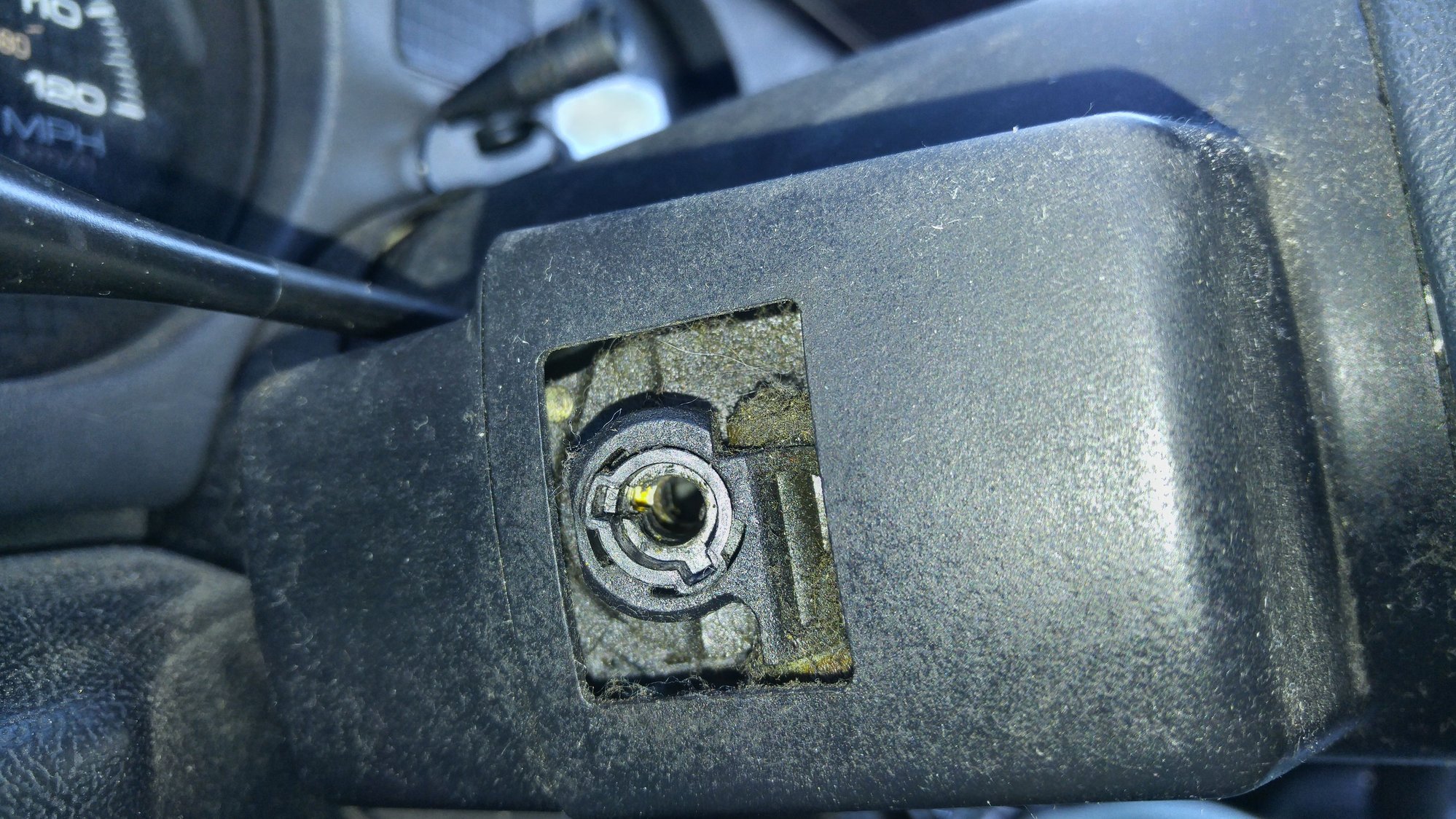

Nope, something is wrong. Yesterday when I looked into the switch where the lever inserts, there was a small tab that stuck out a little bit. I think that's the part that ends up in the groove near the tip of the lever.
I tried to push the lever in, but it wasn't moving. I looked and it seems that little tab has moved and now it's completely blocking the opening.

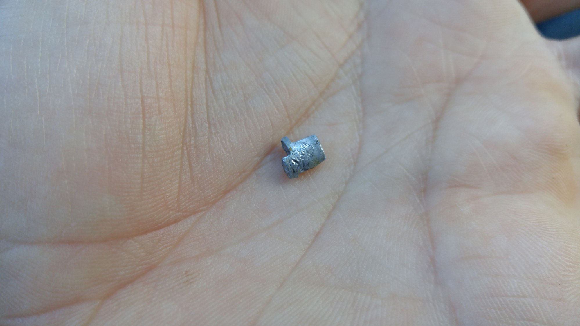

So, the pieces of metal I saw blocking the opening was in fact a broken piece of the switch. I used a paper clip to fish it out. I was finally able to get the lever in, but i can't turn off the wipers. I can operate the intermediate, lo, and hi, but it's loose in the CCW direction and won't shut off the wipers. I guess i need to replace the switch.

The piece broke off just inside the opening where the lever inserts. I looked at what the "turn signal switch" looks like and I'm not sure that's the right part.

If the part the lever slips into is busted, that would be the wiper switch. The turn signal switch is driven of an arm that goes between the two switches.

It's definitely the wiper switch. I'm having trouble finding a replacement part number. All I find is a generic switch that looks like something from radioshack. Anyone have the part number?
