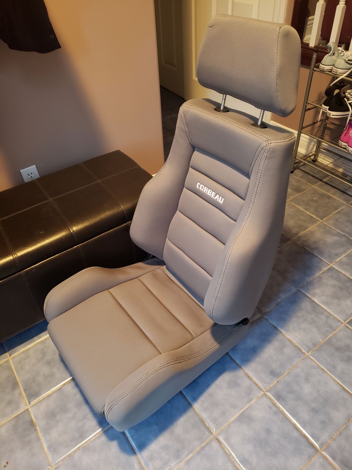

Here are my wedge brackets with corbeau gts II's. I haven't installed them yet but will let you know next week how it fits and how the factory ones compare.
I know one advantage of getting the proper aftermarket set is you can upgrade to double locking sliders.
