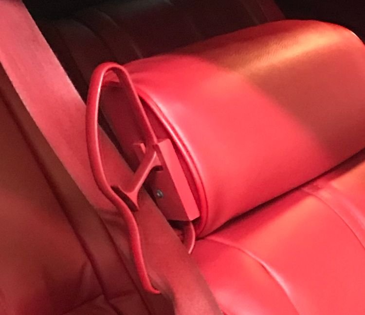

After much searching like you, I came up empty. So after studying the problem, I realized even if I replaced with the same design NOS or used , it will just happen again, it's a poor design. I also wanted to keep the original upper and lower belt loops.
I ended up machining a piece of black polycarbonate on the mill, then painted it. Slotting it and sandwiching the original piece. It may look a bit ugly, but I kept the functionality. And kept the original screw hole locations.

^That looks good.
