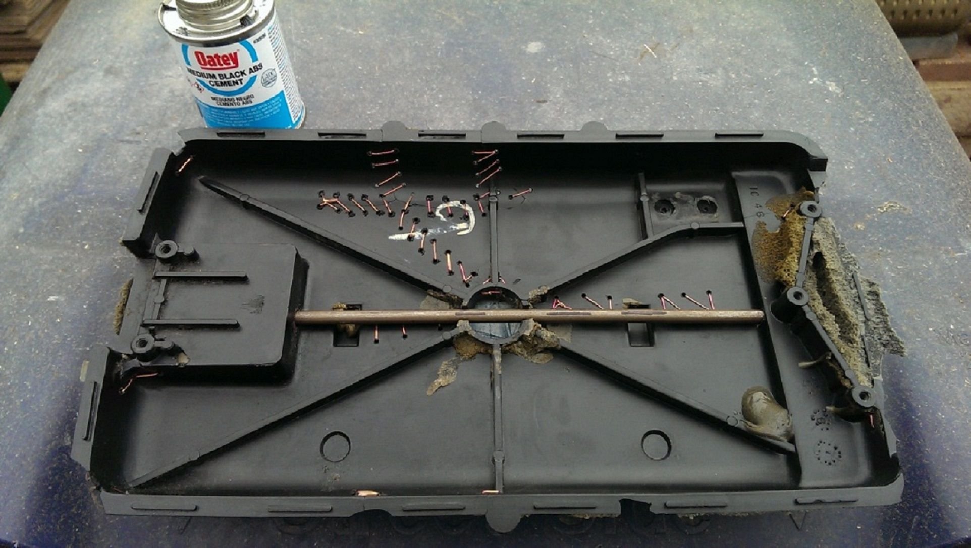

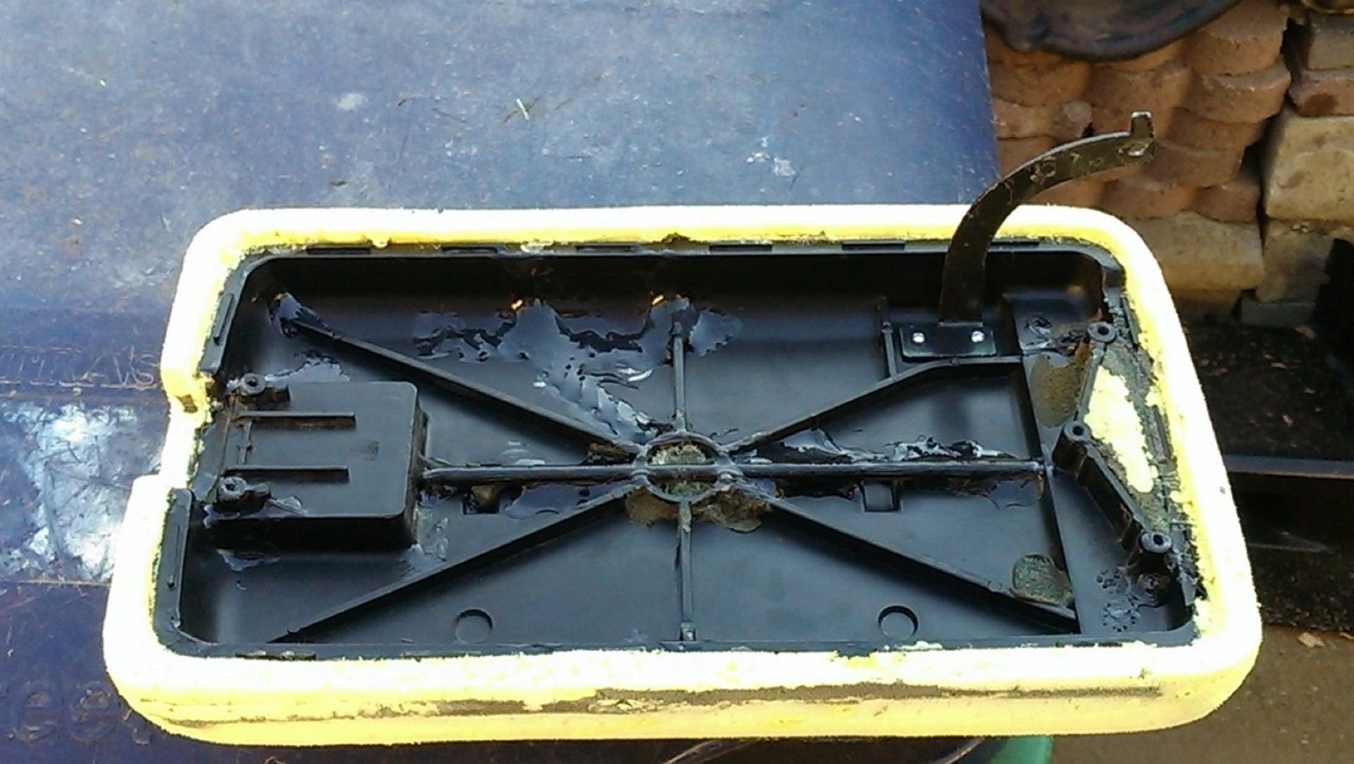

I fixed a JY piece with a steel rod, copper wire and Oatey, then rebuild the foam padding and reupholstered in leather.

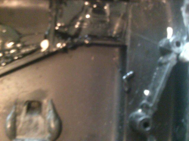

I fixed mine with shop industrial 2 part product that my bud uses at his body shop.It was in a big gun and mixed a&b parts at the tip of the gun.
It fixed mine up good!
Fuzer filling cracks
Filled and clamped
filled and clampted

Yeah, spray type.I used the one that stays pliable.Sprayed on what was left of the original, then sand/shaped it.
The copper wire is key to keeping the broken pieces together, steel rod keeps the lid from bending when i accidentally put my arm on it.

84........My plastic was all cracked but the top was in great shape. I used the fuzer to fix both sides of the crack with a few paint
sticks lined up side by side for strength. Gotta work fast cuz that stuff dries quick! (no pics of that cuz of working time). Used the fuzer
to glue down the edges of the soft cover in place.
Came out good tho.
The repops aint too bad but no spring or push button so they flap around!
A bud got one on line.
