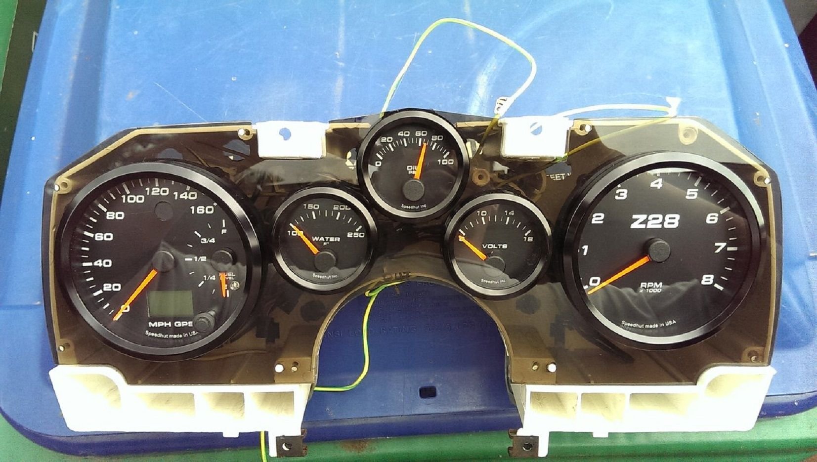

If youre willing to do a gauge w/in a gauge to fit all six gauges since Gm put the oil in the tacho, yes. Speedhut gauges here, but not a direct drop in.

I don’t think any aftermarket gauges would be a direct fit. But those gauges look good. Is the Speedo gps? Speed hut guages would be the direction I think I would go. Have you had any issues with them?

I see it is, they look good

Yes, gps, no serious issues.Had a sender go bad, but speedhut send me a replacement free of charge, lifetime warranty ftw.

Wow, that looks great! I was thinking I might use the single gauges but add an extra cluster for air/fuel, vacuum, and the "extra" gauge that didn't fit in the stock locations but I like that 2-in-1. Probably a stupid question but are they mounted to the metal frame behind the plastic paneling?

Theyre mounted on a plexiglass template in the stock cluster. The bezel is hand cut and its wired up to just unplug from the dash like the stock gauges did.
