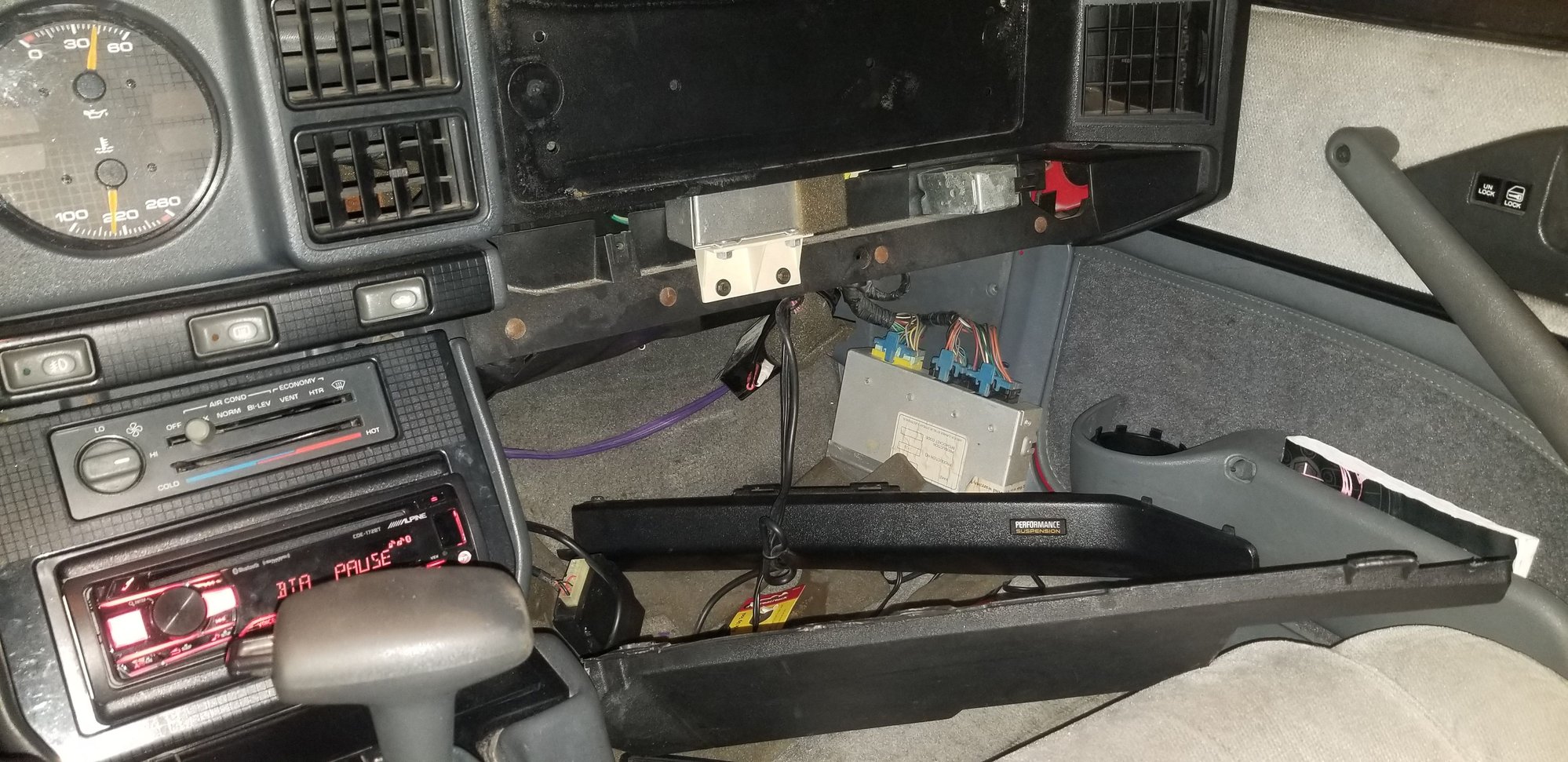

TL;DR: Cannot find the top screw on the heater core cover on a 92 Firebird
Hey all, I know theres a few other heater core threads, but from what I can see its mostly stuff on the early 80s models, and from what I've read its different on the later models. As the title says, I have a 92, and so far its been a real PITA trying to get the cover for the heater core off. I've already done a bypass hose for it so I can at least drive for now (it's my only car), but I would like to be able to pull it out and see if I can save the core before winter rolls around. Now, of course its the top screw thats giving me problems, and so far I haven't even been able to see where it is. I'm attaching a picture of my mostly dissassembled passenger side dash in hopes that someone can point out where the screw should be? I'm also wondering if anyone could tell me what that silver box below the map bag is, and if it would be safe to remove that/ if it would give me access to the top screw. ALSO managed to drop my only 7mm down the windshield defrost vent while attempting to remove the dash pad, so I need to figure out a way to retrieve that as well Sorry for the long winded post, and sorry if this should be in a different forum instead of interior.

I did my heater core this past spring, not a lot of fun but do-able. To reach that top bolt I needed 2 extensions for my ratchet. With 2 you can reach the bolt from the front just barely. I did notice you left that box that you were asking about in place, I would remove the bracket and with that gone you should be able to reach the top bolt with the 2 extensions. It should be almost a straight shot but if you can get your hand in there to find it and guide the socket that works too.
Awesome, thanks!!! Just went out, turns out the extension I got at the hardware store was the perfect length to get that, just had to remove the box. Thanks a bunch!
