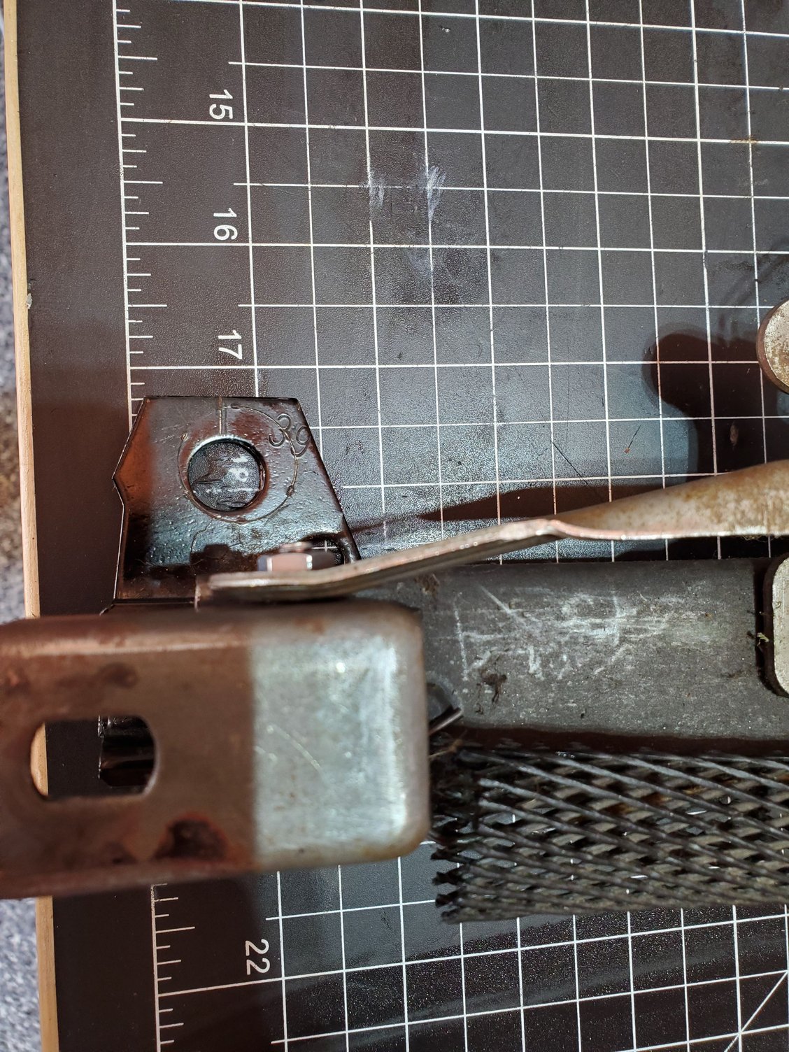

So mine does not look like it will be the plastic bushings...unless they are bad also.
I have what looks like 2 rivets that broke on the inside track. I have the seat out, but have yet to remove the mechanism from the bottom of the seat.
I have been waiting , thinking about how I will reconnect it.
the pictures are not the best.

I put my seat back together with some flat head SS bolts and lock nuts. No more rocking so my issues was NOT the plastic bushings in the tracks,
I did discover its a common problem with plastic bushings n the C5 corvettes and there are replacement bushings.
Maybe they will work or can be modified to work?
