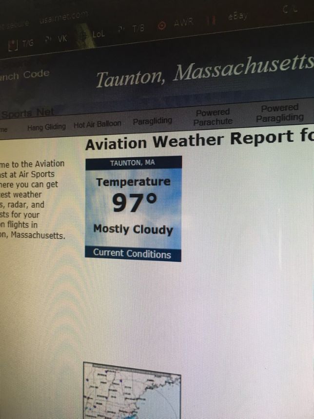

Good call Mikos, I live in the northeastern U.S. and we have August days when the A/C is absolutely essential.......
