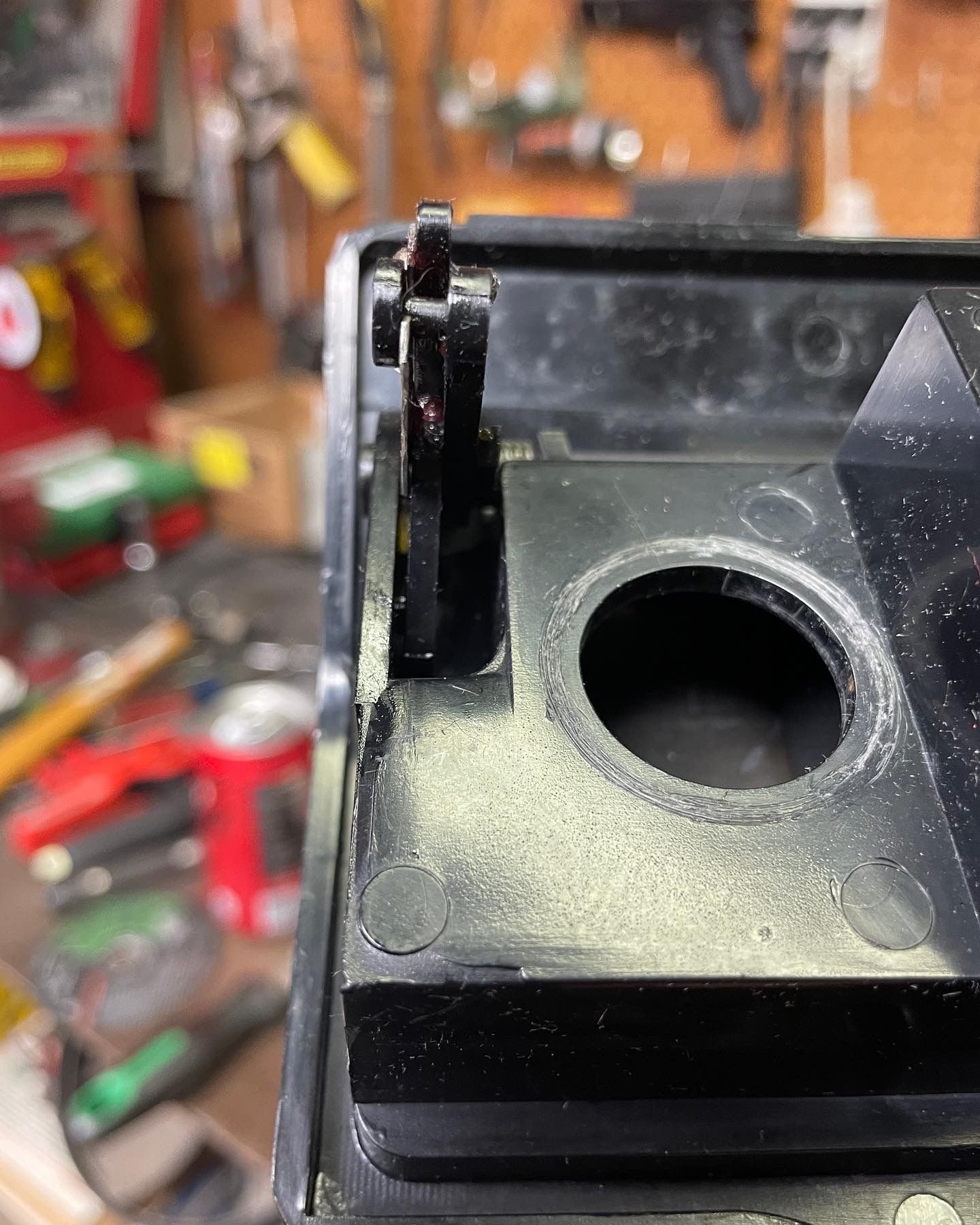

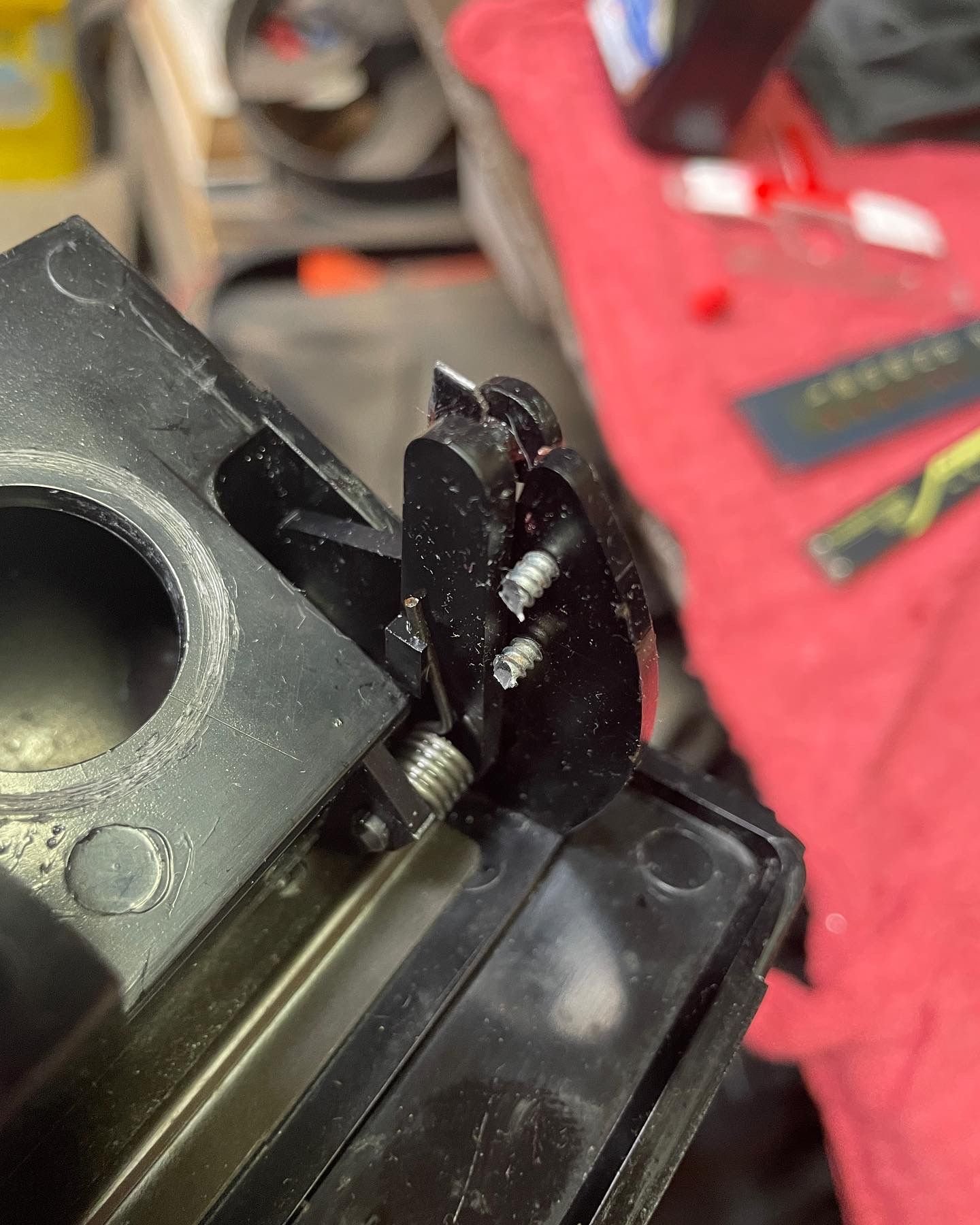

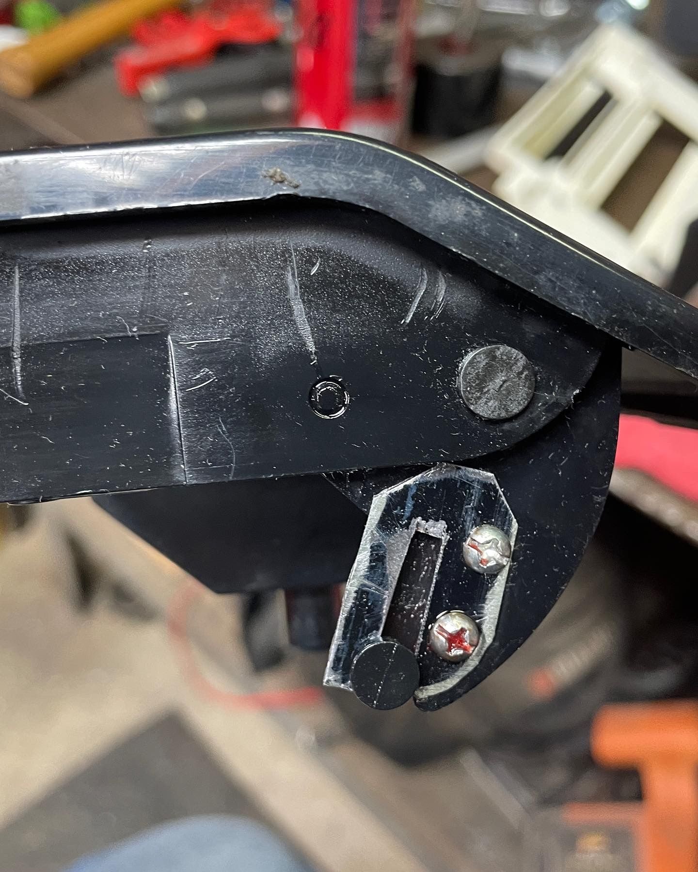

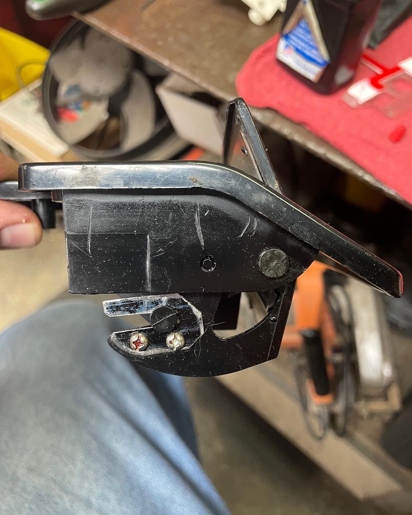

Interesting I just fixed mine last night, how this is designed I would imagine most would break similarly, I'll post pictures later to show how I fixed mine.

As it’s already been stated there’s a number of things that could broken, my problem was one side of the slot that the spring load pin rides in, I took a piece of banding material and cut it to the shape I needed, drilled hole and added a couple course thread screws, with a little adjusting and a little oil it works again.
