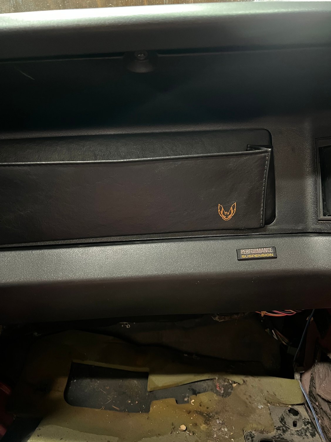

Hey guys, I’m new here. Attempted to use the search and was unable to find an answer. My question is how do I remove the panel right below the “map” pocket. I have already removed the 3-7mm screws but something up top is hanging me up. Looks like plastic tabs that potentially need pushed then pulled down? Any help is much appreciated

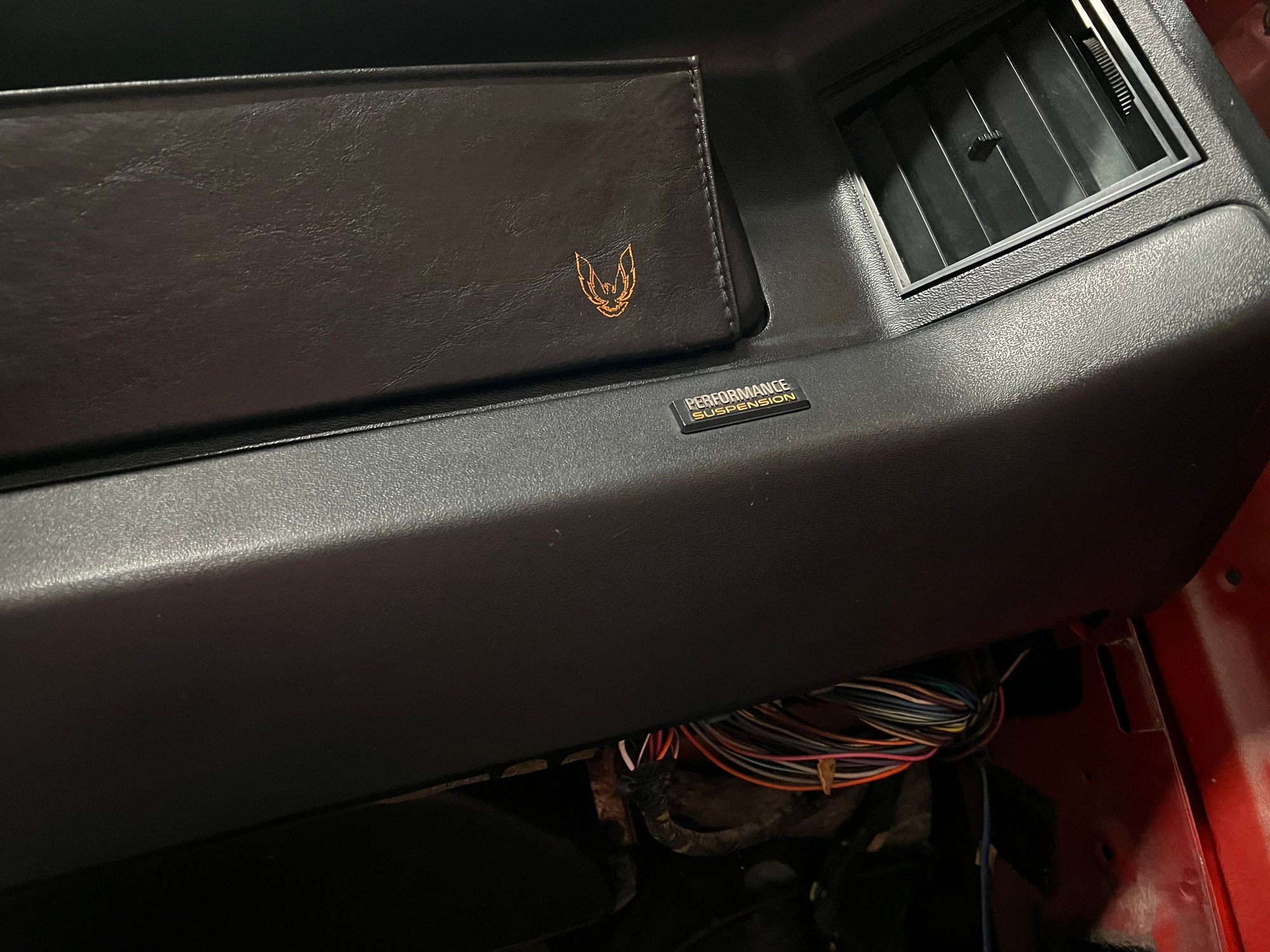

There should be one small screw near the wiring bundle (back right side of the panel) that goes into a slot on the panel. It isn't a hole, so the panel can be removed but that screw makes it easier. Other than that, push in on the panel and wiggle it around a bit. It has tabs that hold it up top behind the map pocket but they do pop off. Just be gentle since it's a brittle piece.
