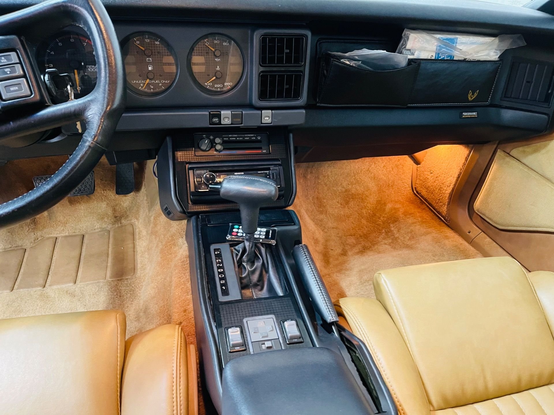

I really prefer the look of the 90-92 Bird interiors. I got everything for cheap to do the swap.
Gauge bezel
Defrost/trunk/fog bezel and switches + connectors
Driver side knee pad
Driver side underdash "plastic"
Should Bolt in and go?
Thanks!

The switch wiring is different iirc and the supports for the driverside knee pad area is different too. Not sure all the brackets to mount it would be the same.

Originally Posted by TTOP350
The switch wiring is different iirc and the supports for the driverside knee pad area is different too. Not sure all the brackets to mout it would be the same.
for wiring Ill be ok got the connectors from donor car. It was really the knee pad that has me thinking. I have to pull the cluster out to fix the odometer so I'll investigate then.

This doesn't fit. You need the whole dash from a 90-92 to make it work. All thr mounting points for the cluster bezel, knee pad, switch pod etc. are different on the 85-89 dash.
Even the ALDL port is at a different location, also the dash wiring and position of convenience center, blinker relay etc etc are different.
Well, that settles that then haha! Thanks JC
