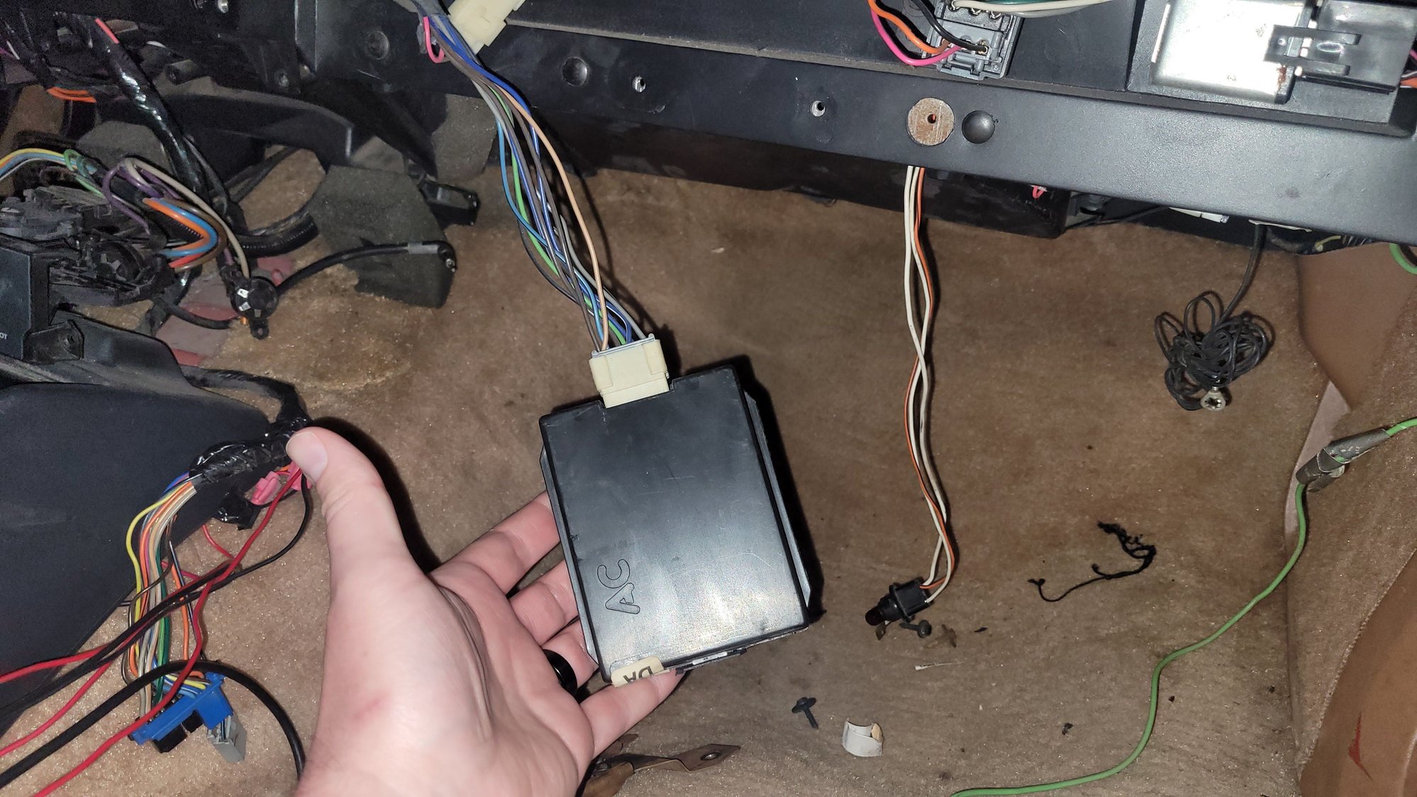

Well, I made a rookie mistake. When I took apart my dash last autumn, I did not take pictures of anything as I was going. So now I'm going off memory, and while that and process of elimination has worked so far, I've hit a road block. Can anyone tell me where this goes? There is a bracket that it might mount to, but not sure, and any idea what this box is?

When my power antennae failed, I had that area of my dash apart too. See the original post HERE.
These are the modules I had.
Left to right, UQ7 Performance Sound amplifier, Cruise Control Module (what you are looking for), Power antennae relay, rear window defroster relay.

I'm pretty sure the black box is cruise control related and it mounts with 2 screws and that bracket just below your hand in the picture. It should mount to the left of where the ground screw hole is right below the relay with the pink, orange, and black wire.

Thank you! That is exactly the kind of picture I was looking for. I hope I can get everything to play nice and go back together correctly. Since now I know that the box is for the CC, I'll check the wires as best I can. The CC has not worked since the swap, I don't have a clue as to what the system isn't 'seeing', or if it's trying to output but can't/won't.
