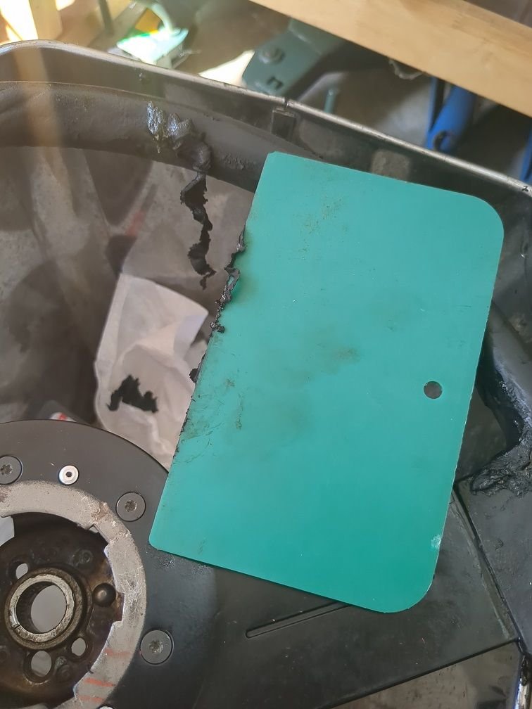

I removed the tarry mess that was under the original leather using an ice scraper that I use on my windshield on cold mornings and a bunch of WD-40. It took about 10 minutes.
Now it is clean enough that I don't have to spend 10 minutes cleaning up every time I touch it.
That "tar" really is just like the beach tar that we sometimes get on the Gulf coast.

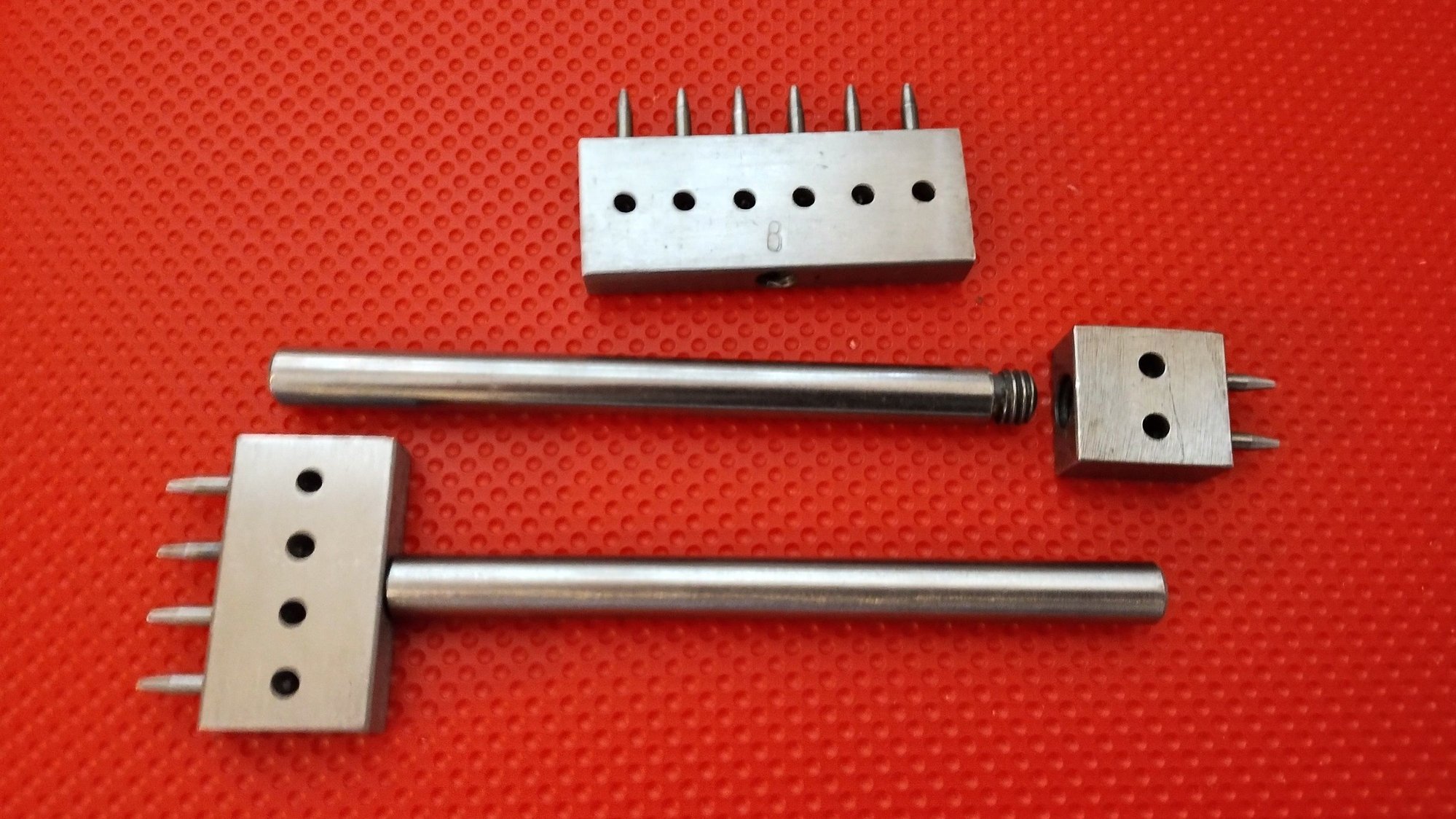

Use the old leather as a pattern for the best fit/look. I re-did my shifter ****, e-brake, console lid this way, but the wheel is a Chuck Pelton affair. Two in fact.
A leather hole puncher is great for the hand stitches. Id love to find a worn out steering wheel and give it a try though. Post pics when you're done.

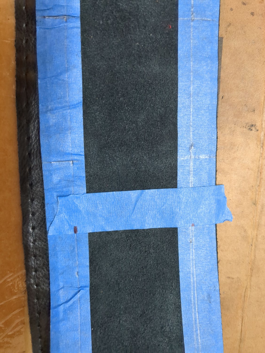

Here is a picture with the $15 leather wrap I bought. You may be able to tell that it is way to wide for the wheel, but the circumference is about right.
I added painters tape to the back so that I could see the marks I was making.
I took a piece of tape and wrapped it around the wheel and marked both ends where they overlapped, to figure out how much extra material needed to be removed. It was almost exactly 2.75 inches. The wrap is 4" so I need to take 5/8 off of each side..or so I thought. I marked up the tape all the way around and made a sample cut about 5" long.
When I wrapped it around the wheel it looked like I had cut about 1/4 too much off. I decided to do a few preliminary stitches and see what it looked like. If I pull medium hard, I can get it close up nicely and it is very tight on the wheel( it doesn't stay that way without tying off the threads, so it is looser in the picture than when I pull it tight). I think I'll re-mark the tape, leaving a hair more and cut the rest. If I butcher this piece too bad, another is only $15, so I'll start over.
BTW, I cut the leather with a box cutter and a straight edge, on a 2x4.
Learning as I go...

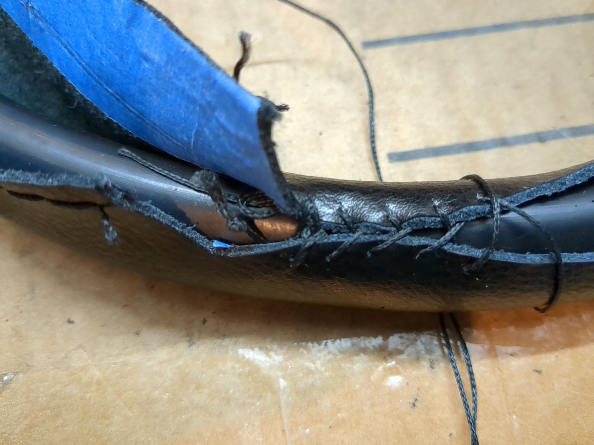

Also, a Sailmakers Palm makes all the difference when stitching. The needles that come with the $15 leather are a little short to hold correctly with the palm, but it works.
Also, during my first test stitches, the painters tape ripped while stretching the leather around the wheel. It won't work for aligning the stitches. I'll have to come up with something else. I may just use a 1/4" spacer and locate the stitch holes as I go.

A little progress today. After all the prep-work of applying the tape to the inside of the leather and carefully laying out the planned cuts, only to end up cutting a little too much in the sample area, I decided to use a different tactic.
First, I've decided that the tape was (mostly) a failed experiment. It worked fine for laying out the pattern of the spokes, but was overkill for most of the cutting.
Second, using a foot long 2x4, a box cutter and a straight edge works great for getting nice straight, easy, cuts.
Since my "precision" cut yesterday was not great, I decided to just eye ball it and am very happy with the result. The first piece that I cut off (today) I used as a width measurement for the rest. I just set it on top of the main piece, lined it up with the edge and used it as a guide for placing the straight edge. I had the whole thing cut out in about 10 minutes. Pictures to follow...

I stalled on the difficulty of sewing the leather. It is really hard to get the needle through. The sailor's palm makes it possible, but it turns out that I'm not very good at getting the holes in a straight line, while using the palm. I'm sure an experienced sail maker would whip right though this, but that isn't me. I think that I need some sort of jig that will hold the leather in place and help me space out the holes evenly, so that I can create the holes. Then remove it from the jig and sew it on.

Since the generic leather wrap "kits" are pretty cheap on amazon, I assume that they are machine cut/holes for mass production. I've been wondering if a laser cutter would work on leather. Might smell like a BBQ, but if it worked and the program was shared, that would help lots of people.

The leather kit from amazon seem to use wider cut of leather for our thinner wheels. Maybe trim it down and re-do the holes.
I used these little hole punchers i got on thE-bay. They're cheap and work well for making the holes to stitch leather. Ive re-done a couple e-brk handles, my console lid and shifter ball with these, but no wheel yet.
