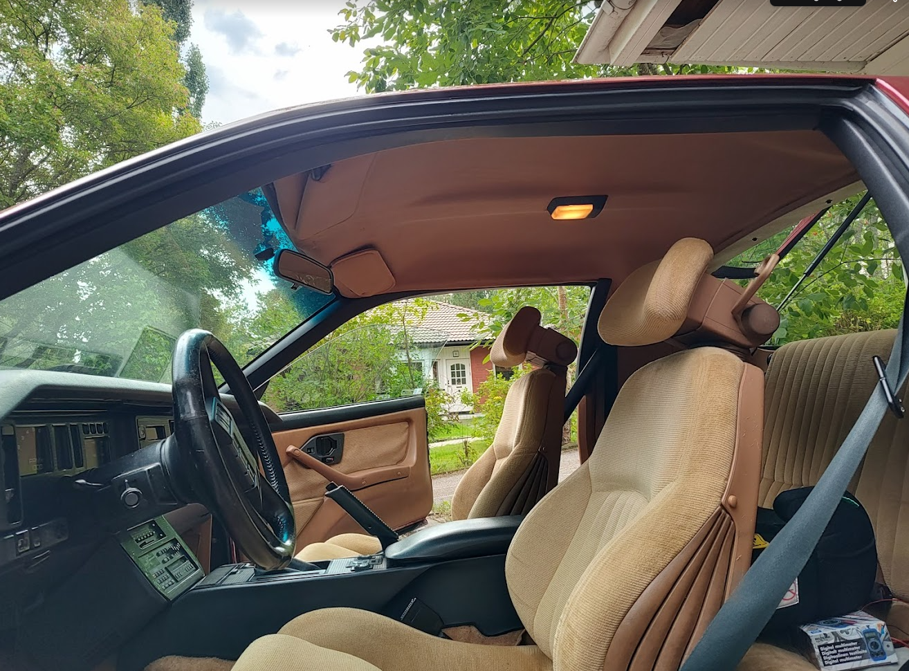

Last week I installed a new headliner from PUI interiors in my 1988 GTA. Fitment was really good, apart from the front, which I will surely be fixed with some velcrotape.
Took about an hour to remove the old one and install a new one, with my spouse helping me.
