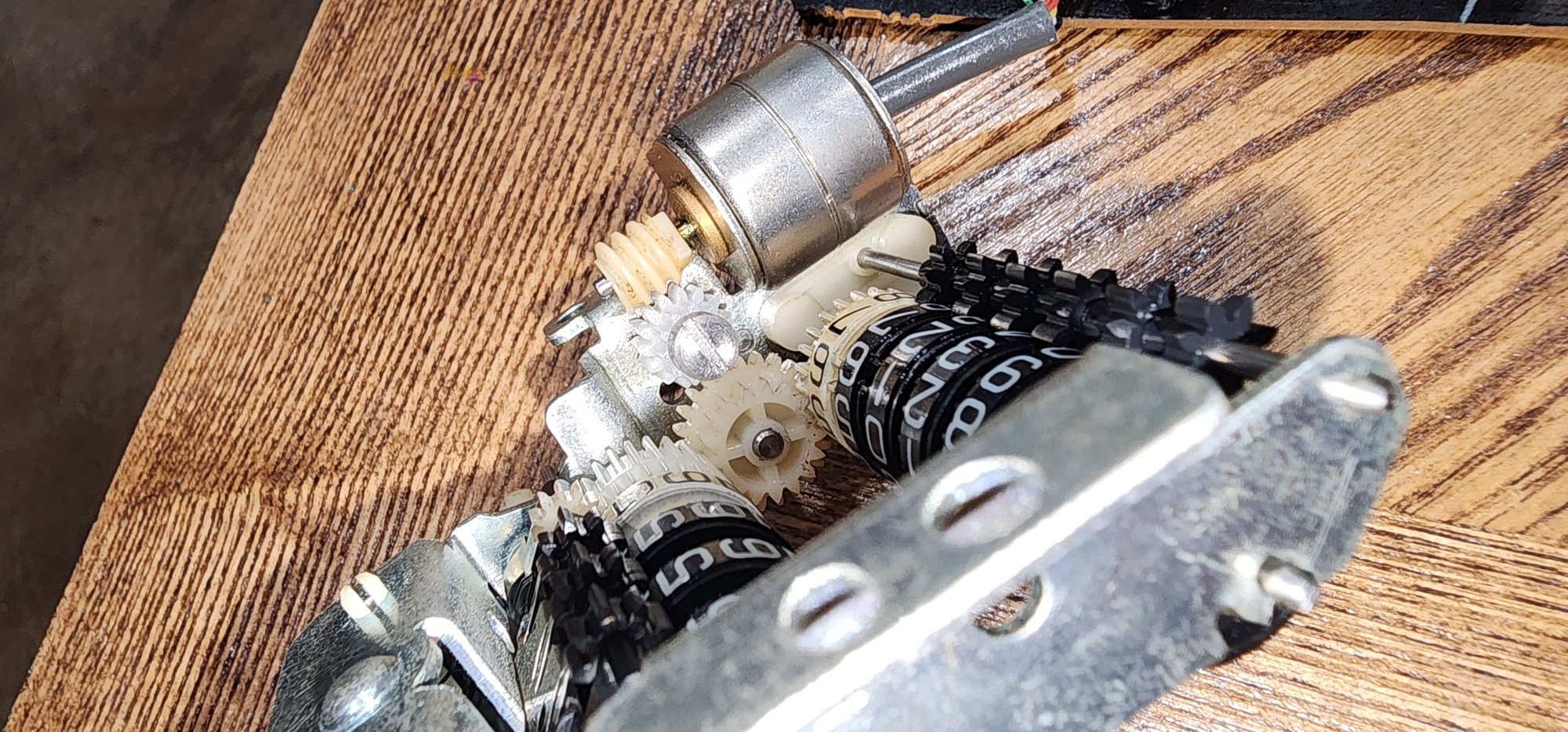

Replaced odometer gear and now speedo stopped working
1988 trans am GTA with 140 speedo.
My odometer quit working because of the plastic gear giving out like normal so I replaced the gear, put everything back in and now my speedometer and my odometer isn't working. What's the first thing I need to check? Was super simple swapping the new gear in so I don't think that is the issue. All other gauges are functioning except this one. where to i check first?

Teeth did break and speedo was still working after that I just noticed the odometer wasn't spinning. Now after the gear replaced neither work

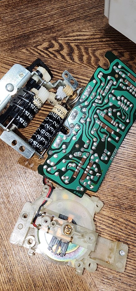

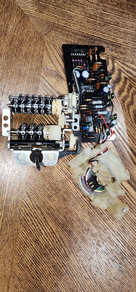

Took it back out. Looks like all teeth are good. I can spin the screw on the motor with my finger and odometer and trip move. I'm guessing I need to replace the board to the motor because I'd the motor fails then the speedometer should still work right? If they both aren't working than that makes me think board. I don't see any burn marks on the board though

Is there a way to test the motor and circuit board to rule them out?
