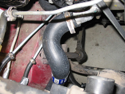

ok, heres some pics... i didnt get them all thru my email yet, but heres what i have:
heres the first pic of the silverado hose.. you can see my complaint about it.. it hits the idler arm mount.. it did come with this corragated, "protector" crap... but it looks like ***... its only on there so i can run the car while i was looking for other options...
Attached Thumbnails ls1 with stock radiator?-c-documents-settings-cat

ok, notice that small hose in the first pic? thats your coolent bypass/ steam release whatever hose... basicly it lets the air out of the head so steam doesnt form/collect there.
i screwed a nipple adapter in there and hooked it up.
naturally, as soon as the car warmed up, the damn thing cracked... i used some epoxy to fix it for now... im just ordering a generic aftermarket alum radiator soon... i'll get a bung tigged on it... much like i suggested to you.

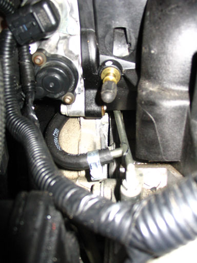

and incase you're curious where the other end of that coolent bypass hose is, here it is..
i removed the throttlebody part (like thethrottle body coolent bypass mod) and when i say remove it, i mean, i cut it off, and ground/polished until you cant see it was thereanymore... that gave me enough room to run the hose under the throttlebody, less visible that way.
heres a pic:
you're on the drivers side of the car, looking down under the throttlebody.... you can see the TPS in the pic for location ref...

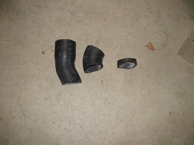

Stole this from my old post:
Originally Posted by 3.1EyeCandy
We worked for a few hours this last weekend, but I took some pictures of current state and thought to post. We started by trying the stock 2001 upper and lower radiator hoses on my combo (ls1 + 3rd gen radiator)....this doesn't fit. Others have apparently managed to massage the lower hose on, but I couldn't see spending that much time and frustration - there had to be a better way. The upper (stock 2001 w/out the power steering cooler) wasn't long enough.
So, thirdgen to the rescue. These are the numbers you need:
Upper: Gates #20893 (Early 4th gen Camaro w/v6)
Lower: Gates #21505 (83-90 Ford F-250 and F-350)
The upper fit fine, but looked a little more factory after trimming an inch off the radiator side. The lower...looked twice the size as the 2001 camaro unit and I honestly thought I'd paid good money for a part I was going to throw away. Never the less I trimmed it where I thought it might help. This was all that I trimmed...
And boy does it fit great!
Old Dec 4, 2009 | 09:55 PM

Got some pics for you Pocket!
I have a 89 F-250 7.5 lower rad hose!
The other pics are what the hose area looks likels1 with stock radiator?-0528101123.jpg

hey budd, is that a stock radiator!..I have my pics on here and your rad looks like the lower hose goes lower...
The hose would work if I put a coupling in there for the lenght you needed for the lower connection....I would shorting that piece maybe....well ...its hot rodding..right..lol

Yeah wow my hose is nothing like that. Mine is short and completely different bends. Was there a change between 89 and 90? I thought someone said the hose required was from a 90? Apparently not lol.
