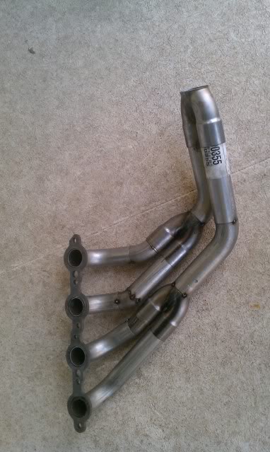

Re: Making LS1 swap Headers
Making custom headers = fun
those are looking good tommy.
The other side looks pretty neat, gotta get a pic of it soon, with the firing order of the LS1 the drivers side header pairs 1&5, 3&7, rather than the front two + rear two of the pass side. Doing 4-2-1 really helps a lot with space, i'd like to do a set for an LSx thirdgen sometime, i'm sure I could get plenty of ground clearance as well as great performance.
Frozer!!!
