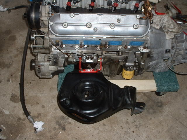

Nick...this is what I use. It was about $50 from harbor freight. Its beefy..plenty strong. 100% adjustable. You can find them cheaper sometimes if you get ahold of a coupon, or when they go on sale. I used it when I removed my k-member to notch it.
Ive never had any issues lining up my mounts. I installed that all when the motor was out though. I installed my stands on the k-member, and mocked things up when I was notching for A/C.
The biggest pain of putting in the poly mounts was getting the old rubber mounts out. The mount kit came with nuts and bolts to put the clamshell back together. No welding required. Just have to drill the rivets and dig the old rubber out. Not hard.
J.
