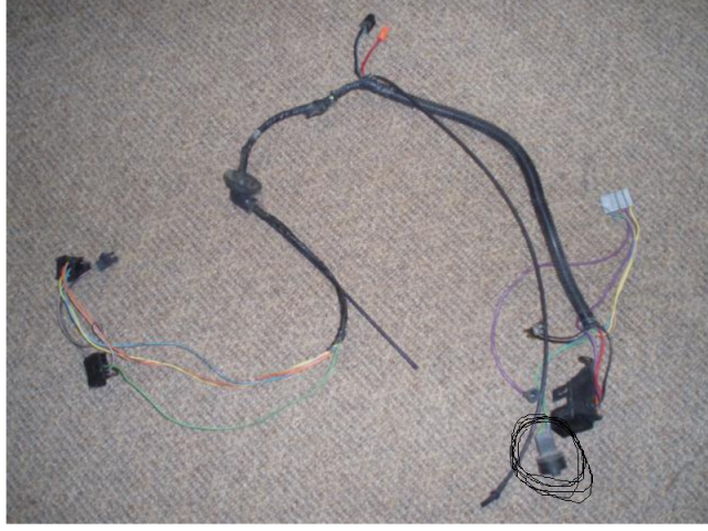

2 Questions for Pocket:
1) That little blue and black pigtail that comes out of the HVAC harness on top in the middle--is that for A/C?
2) Will there be a wire coming out of the harness you build that connects to that red/blower motor wire right by the blue/black pigtail?

Jon, in the pic, I can delete the plug that is circled, right? I think that went to an AC component before.
Also, that black wire goes from the plug (the one with the blue AC wire also) back to another plug and then another black wire comes out of that plug and goes into the relay.
Q: I only have to ground the relay to the chassis, right? I don't think I have to worry about plugging that plug into the second stand-alone terminal that was fastened to the motor housing before, right?
Thanks!
Thanks!
Re: First Ever V-8 swap: LT1/4L60e Swap Begins!!
Yes, the plug circled can be cut out. The green wire at the HVAC head unit is part of it and the blue wire at the black/blue connector is the other. Cut it out completely or just enough to hide, it makes no difference
The relay/fan motor can be grounded to anything steel. Engine block/heads or chassis. Just be sure theres atleast one large ground strap connecting the two when you're done

Thanks Jon.
