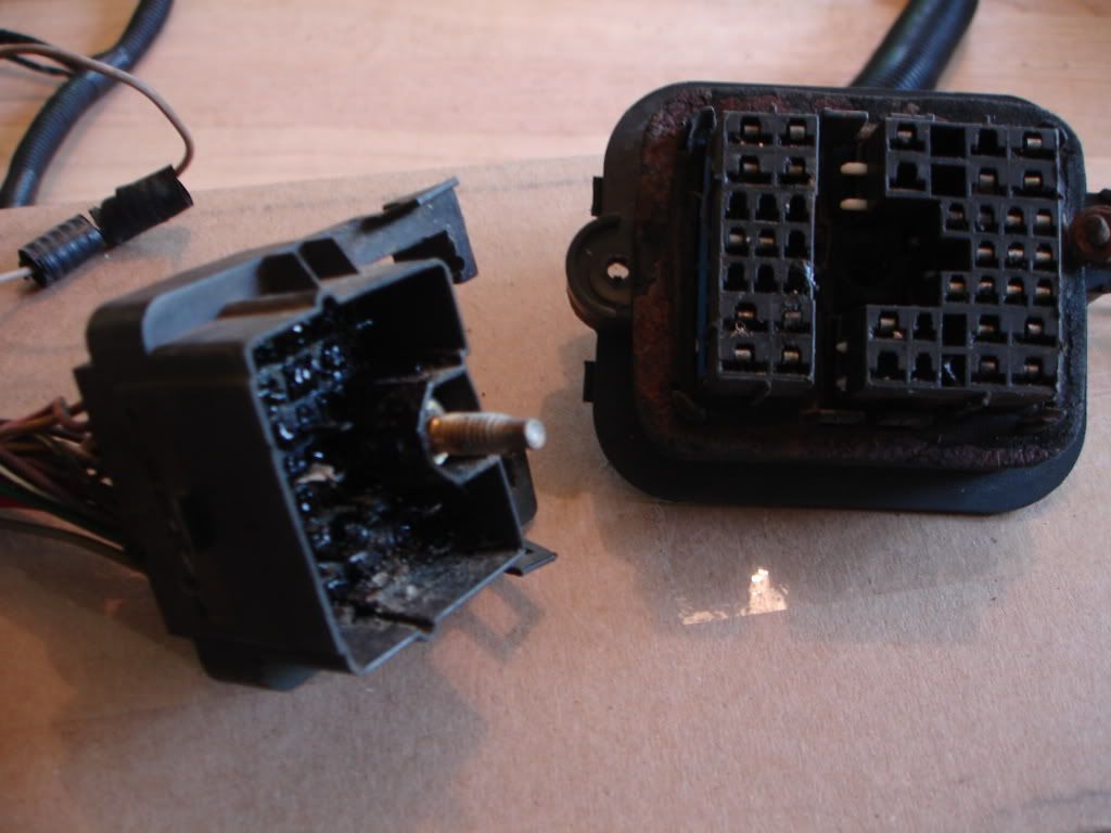

The connectors between the engine harness and the dash harness is melted (see album) is it done for? do i have to replace the whole harness or can that one piece be replaced?

Your melted connector would probably best be handled with new harnesses. Depends upon how much damage there was.

I agree with 57kid, get a new dash harness especially if it's hacked AND Melted. Grab an LS1/T56 harness and have Pocket rework it as needed.

Also, wheres the damaged connector? You've got lots of pics of the 3rd gen C100 which is supposed to be covered in that nasty brown goop. Yours is missing the main harness cover, but it simply keeps the sludge stuff in and the dirt out, no biggie without it, just ugly. Find one on any 3rd gen in the yard. It simply snaps on. I see no obvious burn spots elsewhere

Pocket, the 2nd picture in my album of the (C100 connector)<--think that is what you called it. On the inside where the pins are it seems like the plastic melted because all of that gunk is hard as a rock. I could be wrong but it definitely ain't pretty.

Not pretty, but nothing out of the ordinary. If the goo bothers you, then remove it with some electrical cleaner and put new connection jelly in there

Right on man! Glad to here that. I'm going to be cleaning up the harness' today and re-wrapping them! Thanks again. I'm sure I'll have tons more questions soon
