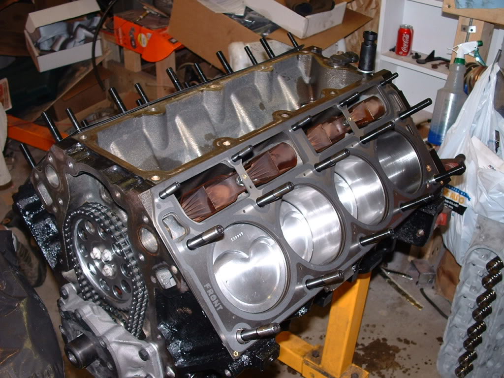

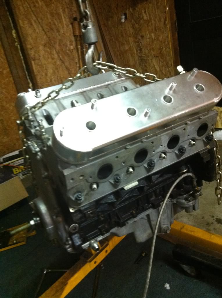

So might as well make my own build thread. Car started out as a buddies TT project. I guess he got tired of it and wanted a vette so I bought it all up. It's an 87 IROC 5.7 T-Top AC car. I've been through the whole car rewiring it all, fixing minor spots in the floor, collecting parts for the swap etc. It's getting there, still need to install the engine/trans. Waited on a new clutch before putting it all together. The motor is a .030 over LQ4 block to 370ci. Here's a list. Compression is around 10.4:1.
2000 LQ4 (.030)
Stock crank (machined .010/.010)
Chevlite H series Cam, Rod and Main Bearings
Compstar 6.125 H-Beams
Wiesco -11CC Pistons (rings gapped for boost)
Comp 236/236 .587/.587 112.5lsa (Turbo grind)
LS6 intake
Ported TB
42# injectors
Nasty fuel rails
GM LS7 Lifters
Trickflow Hardened pushrods
Melling High Pressure Pump
JP Performance Double Roller Timing Chain
GM Performance Head bolts
ARP MAIN STUDS
LS9 Head gaskets
Patriot Stage 2 215cc/58cc chambers (Ported)
Patriot .650 Lift Springs
Stock Rockers
Aluminum Valve covers
Stock Front and rear Covers
98+ F-body Oil pan (with -10an drain) (with windage and pickup tube)
TR6 plugs
2000 Truck Coils
