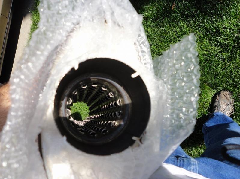

I have the same exhaust. Here's my 3.5" single muffler and it isn't causing any restriction!
Could be the cam indexing. Could also be knock sensors pulling out too much timing.
LS heads respond really well to exhaust side porting. I'm highly suspicious that exhaust is limiting, in your scenario.

The real question is how much power can the muffler support without becoming a significant restriction that limits power? As far as I know, that is a 3" internal pass-thru, despite the 3.5" stubs on the ends.

I had in my mind, 750rwhp.
We know Storm Trooper put 718rwhp through the exhaust - with a Maggie.

With a supercharger is the the key word. Naturally aspirated engine is way more sensitive to exhaust size. A few psi backpressure (I hate that word, it's so technically wrong!) makes a lot of difference how the cylinder fills. Looks like 3.5" pipe is worth about 470 hp (flywheel) before it makes sense to jump up to 4" pipe, which is good to about 650 HP.
What I'm not sure about is how much power is robbed by not following that rule. I have seen examples of 70 - 90 RWHP on a stroker engine like mine. Easy test on a dyno (with and without exhaust) but everybody is holding out their hand for another $100 every time I look at a dyno. I want to make sure any more dyno time is well spent and not for one reason at a time.
Exhaust might be an issue but I am thinking I need to get the engine sorted first. Not convinced I'm there yet.
