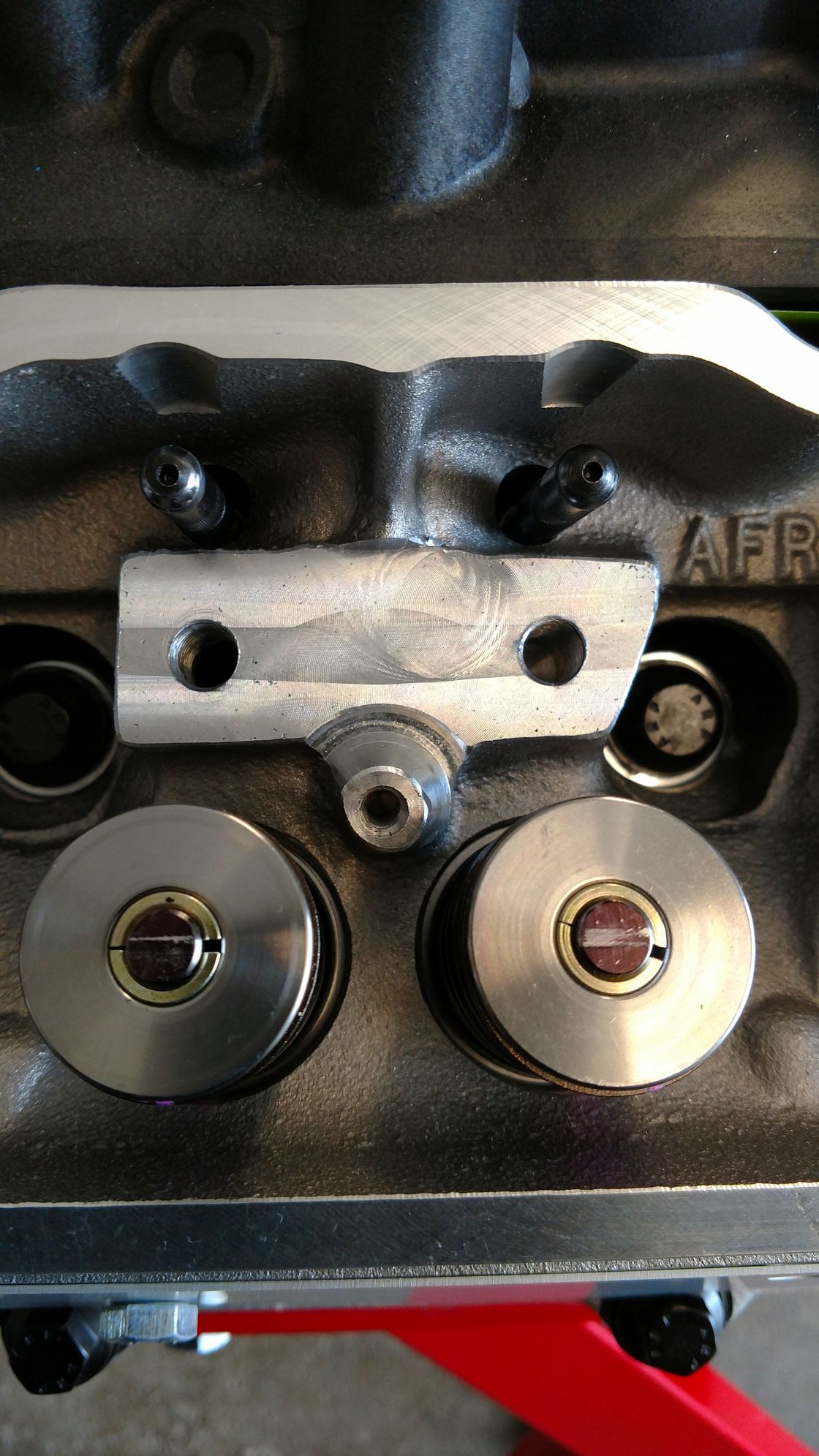

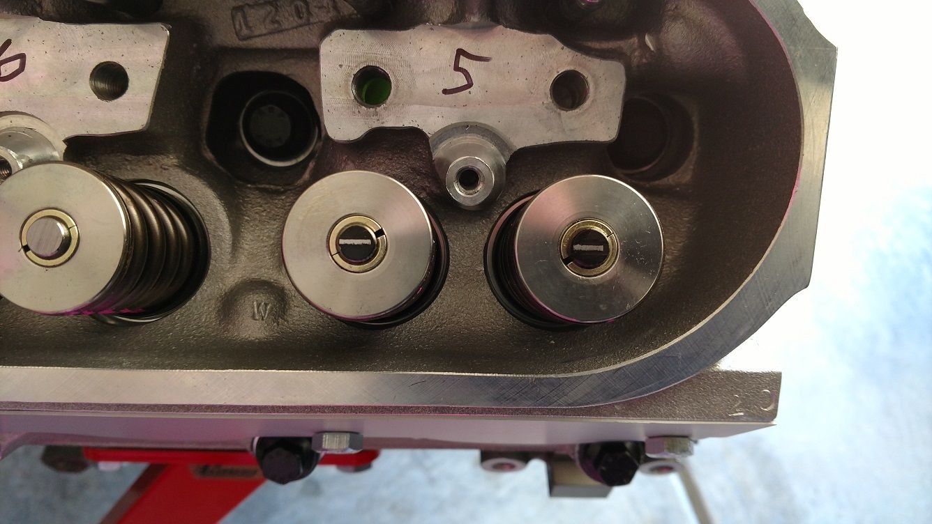

Getting the Mamo 265 heads bolted up to the LS7 has been a bit of a challenge. Trick Flow instructed me to use ARP head stud kit for LS1, part number 234-4317. Problem is they don't know what they're talking about.
The larger M11 studs are correct, but the smaller M8 studs are too short. The heads require longer LSx style studs in those locations, which is offered only in the outrageously expensive ARP 2000 material, part number, AFG2-725-2LGB. Just sucks paying another $100 for 10 little, lousy studs.
But the real problem has been the Cometic head gaskets. Every time I remove the heads there has been an oily substance on the gasket compression surfaces. I've done this 5 or 6 times and it keeps getting worse every round, and the gasket coating has been ruined from the clean ups. Cometic is clueless why this is happening and won't help with cost of replacement. So $180 later I have a new set of gaskets... and yes, I'm kind of mad about it!
I ran a little experiment and rubbed a small area of the old gasket with brake cleaner and sure enough, 30 minutes later the oily droplets formed on the surface. The only theory I've got is that the porosity of the aluminum traps some of the brake cleaner in the metal and that ends up contaminating the gasket after assembly. So this time I let the engine and heads air out for 24 hours before assembly. Don't know if it worked and I don't really care any more. Just leaving it alone and moving on.
Final outcome is 69 cc head with 0.040" thick gasket, producing average 0.035" quench, and about 11.7 static compression ratio.

Which set up would you run? I don't like what I'm seeing here but at the same time I've heard LS7 rocker geometry kind of sucks. Each washer is about 0.047 inch thick.
Just for reference, Mamo normally ships with 0 or 1 washer because that is maximum that will fit under stock valve cover with a Yella Terra gasket spacer.

I am no expert, but it is right in the middle with no washer.
Re: What ever happened to QwkTrip's car anyway?
As we all know, it's the width that's important here and not so much the centre contact patch that so many seem to think is the correct result. Within reason of course.
That said, we experimented with the YT rockers on the LSX I've posted about. The end result is that we switched back to the stock LS7 rocker arm as we couldn't get proper VGT. I'll have to revisit the build notes to recall exactly what the issue was.
I don't like any of those. Did you call Tony? He can ship you out a whole slew of shims so you are not spending your evenings in the hardware store with a caliper. If you leave it like that you are missing out on a lot of lift. Are you using a sharpie or dry ink marker? I found I couldn't get reliable results with a sharpie. I had to use dry erase marker and everything became easier and very clear without smudging.
Granted my MMS heads are cathedral but here is the wipe I ended up with using his shims.

You want both but centered is the lesser of the two evils. If you aren't centered than the rocker scrubs the valve tip and side loads the valve against the guides, prematurely wearing them. If you are too wide you lose cam lift and leave power on the table.

OK, got it. I was told if it isn't centered you were side loading. Wide pattern makes sense you're losing lift.
How are you able to change the pattern here? I know with a traditional rocker, you need to change your pushrod length, but how do you "adjust" a non-lash rocker? Where is he shimming?
Here is a pic with good centering but poor wipe. I added another shim to get the picture I posted above.

Yes, he said one shim works but is not ideal. More shims and I will need tall valve covers. Practically everyone is running one shim and having good results.
Machinist blue dye.

Good choice using dye. I struggled with my pattern a lot. I eventually used both shims he gave me and it ended up being perfect. Just try using all the shims and see what it looks like. I know you are space constrained on AC box interference but not having optimal valvetrain geometry on a MMS top end is far worse.

I use the head fully assembled with the springs that are going to be used. Lifter and pushrod don't matter since that is lash related and not positional relationship of roller to valve tip. I think I used an old LS1 lifter and pushrod. I verified wipe again once I received my custom length Manton pushrods, and it was still perfect.
Posts: 10,439
Likes: 2,093
Car: '89 Firebird
Engine: 7.0L
I tried rolling the engine with adjustable pushrod and check springs but it was impossible to remove the pair of rockers without disturbing the witness marks and I finally gave up. Needed to be an 8 arm octopus to do that. The blue dye marks with the slightest touch/rub.
An adjustable pushrod is too flimsy to use with the real springs.
