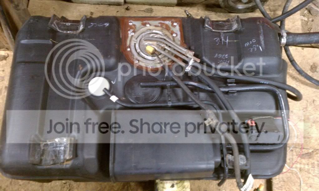

As for the original question.....It can be done. Recently a guy has done it here on TGO but I don't recall which thread.
That was the other way around, a 4th gen pickup (a 6.0 liter pickup, if memory serves) in a 3rd gen tank.
Nope. I was right & found it with a Search. Post #5 shows it.....Post #14 is his Reply confirming it.

Re: third gen sending unit fit in fourth gen tank?
I'm not particularly fond of burning up in a car fire, so I will stay away from the screw & caulking approach.
Not meaning to hamper anyones creativity, but RTV is not meant for immersion in gasoline.
