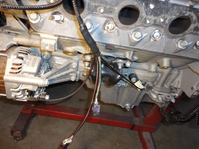

Looking for some help with my LS2 swap. Thought I was nearing the end - and maybe getting ready to check for oil pressure (no plugs) but had heat/smoke come from the rear passenger side head ground stap wire. Traced wires and checked posts most of the afternoon, I'm stumped.
Harness was modified by Speartech. I tied into his harness at C100 by the brake booster for ignition and constant power. Used the GTO battery cables - on the positive side I tied in the 1987 camaro fuseable link leads, on the negative side I connected one ground to the body near the factory fuel pump fuse, the other is bolted to the AC compressor bracket (Which is bolted to the block). On the starter, I tied in the 87 starter purple lead on the small "s" terminal. The GTO harness also had a lead on this terminal as well - I tried connected and un-connected with no difference. Retained grounds on the rear heads, there are several connected on both heads. The car also has a racetroinx harness for the fuel pump, but I pulled all fuses for the pump so I don't think that is my problem.
I should add that the ground strap getting hot happended within seconds of holding the cables on the battery - ignition switch was off with keys removed.
Appreciate any help you all can offer - thanks,
Daren
Attached Thumbnails 2005 GTO LS2 swap - ground problem?-dsc00079.jpg   2005 GTO LS2 swap - ground problem?-dsc00080.jpg   2005 GTO LS2 swap - ground problem?-dsc00081.jpg

Anyway - I recall the problem like it was yesterday. The alternator was missing the isolation washer under the positive battery cable connection on the back, thus completing the circuit through the case of the alternator to the block. The path of least resistance was then the heavy ground cable from the passenger side head to the car body. It was obvious once I took a break from it, and even more so in retrospect.

That would be the bottom bolt - you can see the isolation:
