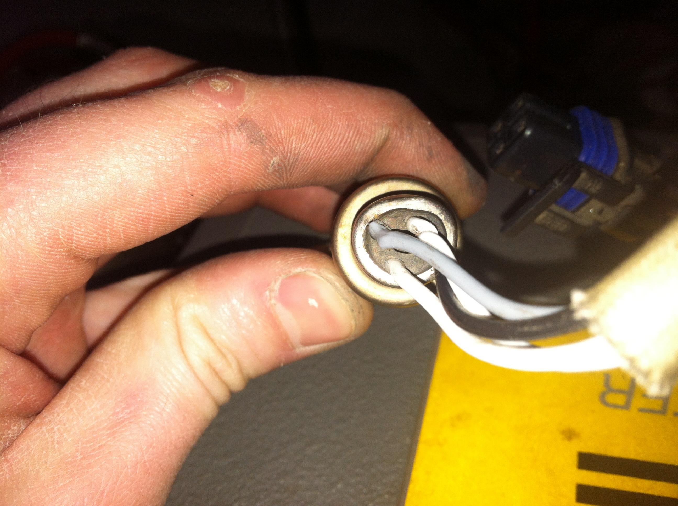

High and lows to PCM ohm'd out good and pin locations were correct for both sensors. Ground and 12V supply was also good for both sensors. I also had the bank one sensor on bank one connector, as well as bank 2 on bank 2, not switched like the tuner had guessed. All wiring checks out, but I did find the bank2 O2 sensor was damaged. The end was close to the floor and looks like it contacted the floor with engine movement. The sensor I replaced it with was about 1/2 inch shorter, and gave me quite a bit more clearance here. Hopefully it was just this damaged sensor...... Still think that if the car was tuned to run open loop, that O2 sensors would have been set in a way to NOT set off the MIL. Maybe its not do-able? I am ignorant to tuning, I just don't know. Will keep this updated as far as my mil light coming back or not.

Two of the wires were bared/ twisted as well as the end of the sensor being smashed
