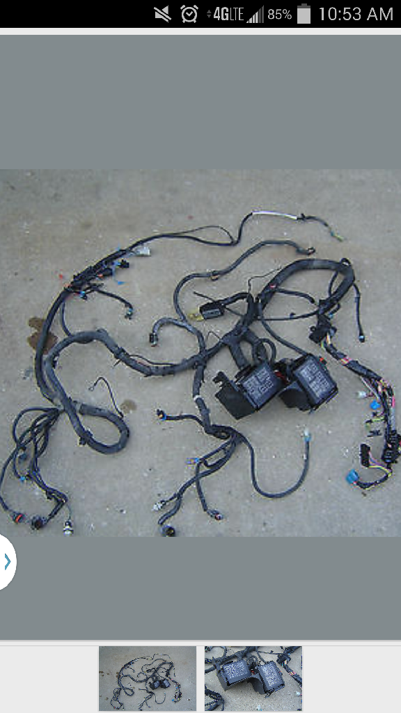

This is the harnessName:  Screenshot_2014-04-23-10-53-47_zpss5gu3ut8.png
Size:  659.8 KB is it complete

What exactly is the harness out of?
It looks nothing like any gen3 truck/SUV harness I have run across.

O2 camaro 6spd

It's real hard to ID a harness with one over-all picture, but I fail to even find anything resembling a generation3 PCM connector.
Not trying to pick things apart, just trying to help you make sure that you have the correct pieces is all.

Looks like the wrong part. Seems to be the head light harness

So I will get my money back

That's a good harness to get to connect the engine/trans to the chassis (most of it won't be used, though). I used the fuse/relay boxes in my LS1/4L60E swap into an '82 Berlinetta (no EFI stuff from the factory).
To pull the damper, I used a regular jaw-type puller and grabbed it by the nubs on the hub.
