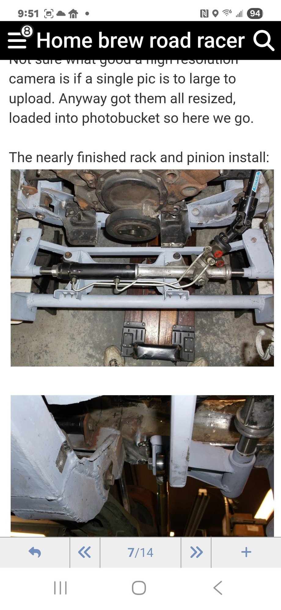

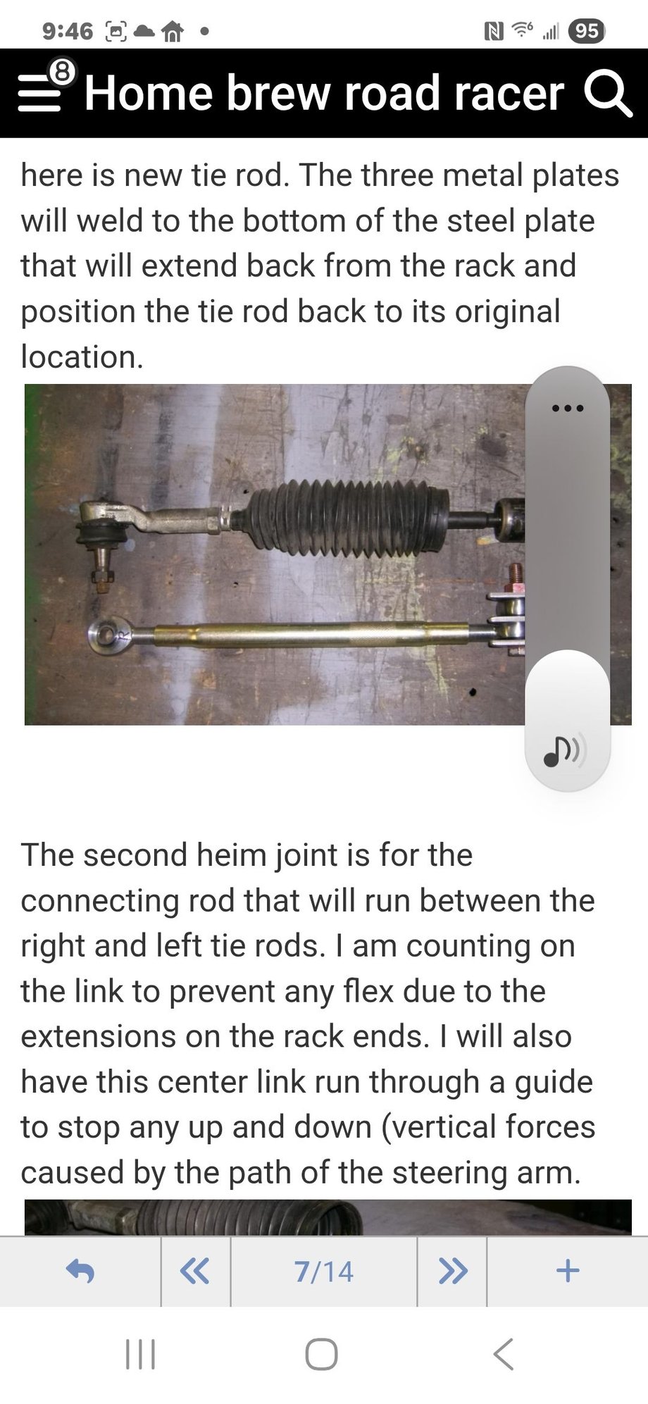

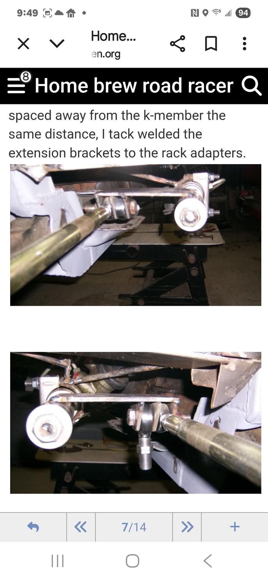

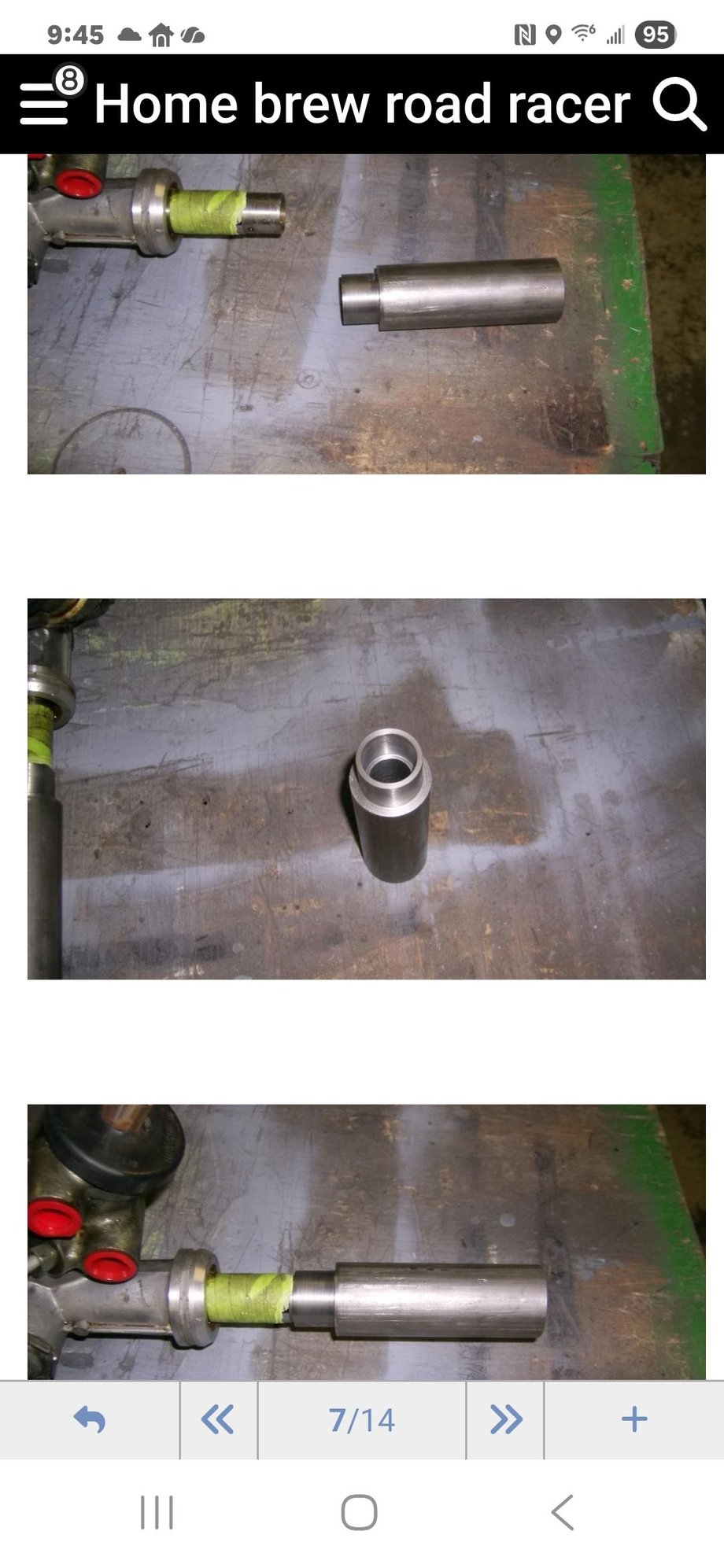

Hi Pocket, I've been following your build. Lots of great creativity and craftsmanship. Im the builder of the "Home brew road racer" here in the fabrication forums. I ran into similar problems when installing a 4th gen rack in my build. I solved the problem by moving the rack out in front of the engine pulleys and making brackets to realign the tie rods with the steering arms. The steering mods start at post 283 on my thread. I've driven the car over 3000 miles so far with no problems from the steering mods. I later added 4 rollers to the drop drag link to prevent the rack from rotating in the housing at the beginning of a turn. Again no issues with the steering.

Hey Pocket, I'm sorry that you had to start over on the front frame, suspension, and steering. Thats a lot of stuff that has to be located in very specific locations to work correctly, so youve got very little leeway on position. I've got just a couple observations/questions about your latest revisions. The first is I dont see any adjustability in the upper or lower A arms. Are you going to shim the upper, and or add heims to the lower?
My second concern is the design of the steering rack adapter. Since I had to overcome the same problem on my build I think your adapter off the rack is too short to allow for sufficient bracing to handle the lateral loads. My adapter is 4" long and the rearward extension is made out of 1/4" plate and 1/8" thick tabs and bracing. My drop center link is made from 1x2 x .120 tubing. I have over 3000 miles of street driving on this setup and have had zero issues with it.
