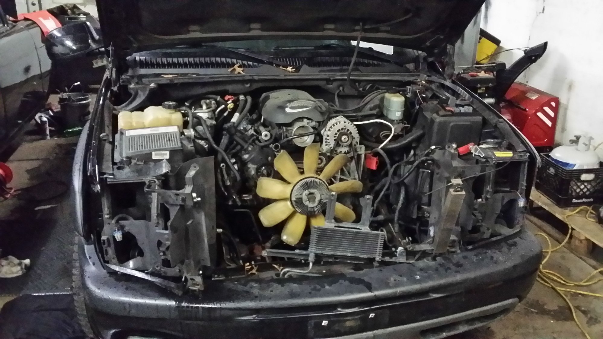

HERE IS THE DONOR VEHICLE

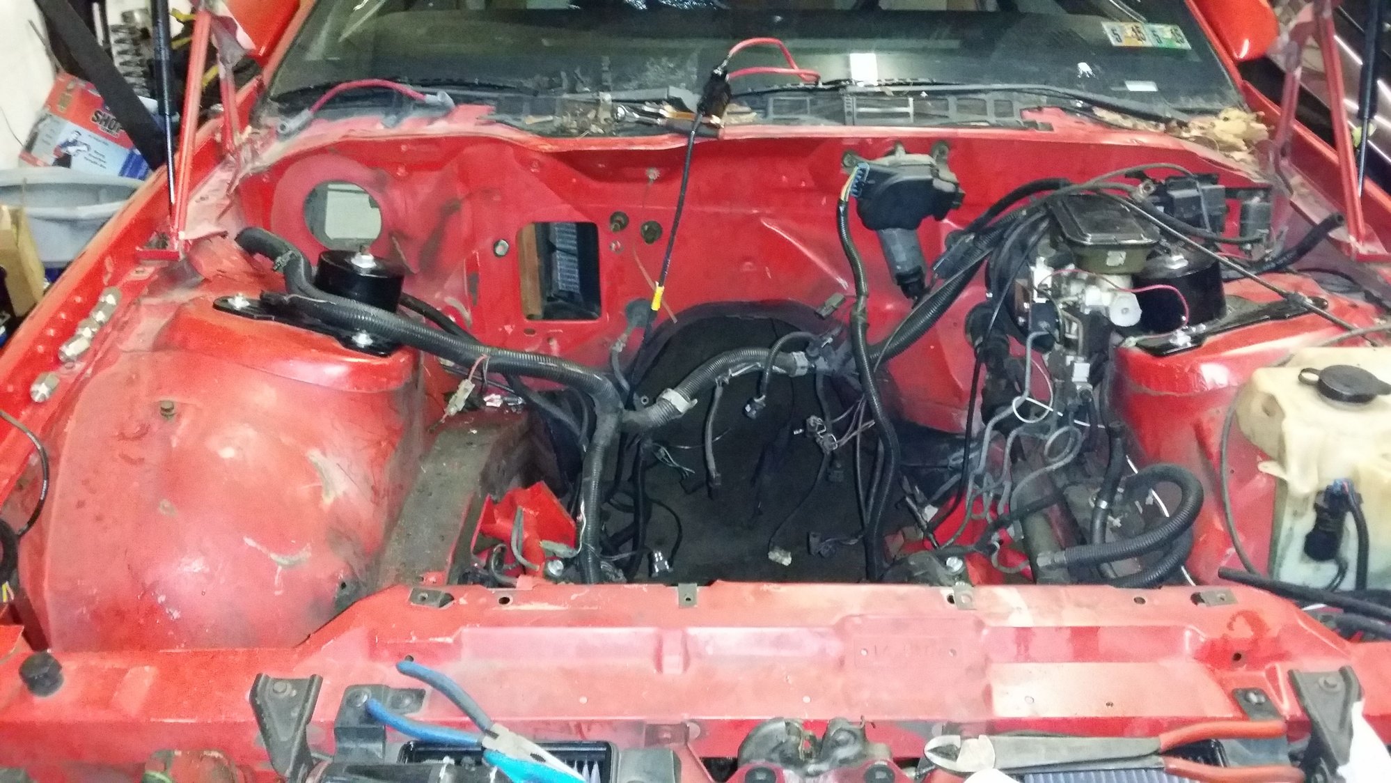

IM READY TO YANK THE MOTOR AND TRANS OUT. SURE WAS FUN GETTING IT THERE

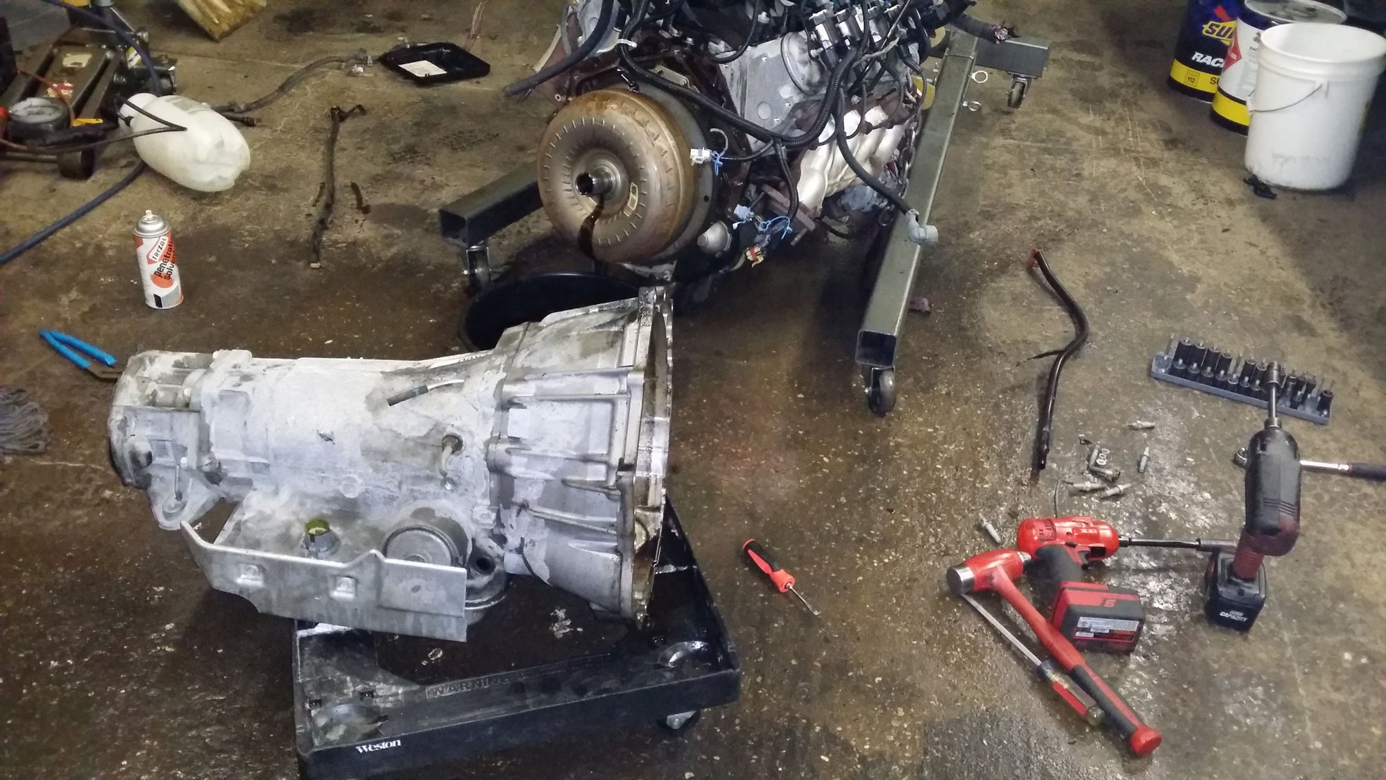

MOTOR AND TRANS ARE OUT NEXT STEP TO TAKE THE TRANS TO MY BUDDIES SHOP AND CONVERT IT OVER TO 2WD

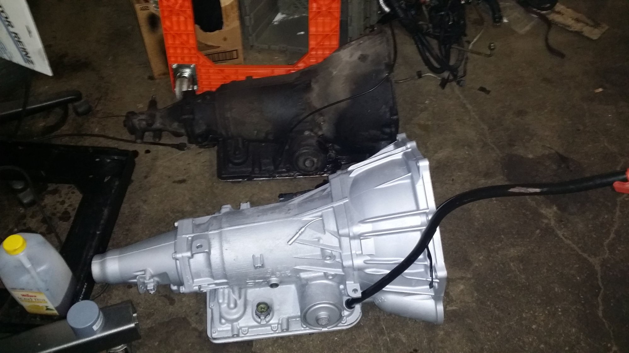

TRANS IS ALL DONE. 2WD TAIL HOUSING SUPER SERVO A HEAVY DUTY 5 PINION PLANET AND A BEAST SUN SHELL WERE INSTALLED

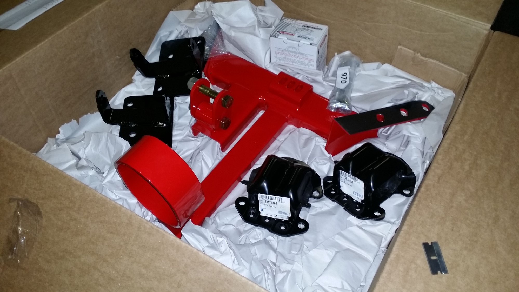

I GOT SOME MORE IMPORTANT PARTS IN FOR THE SWAP FROM SPHON

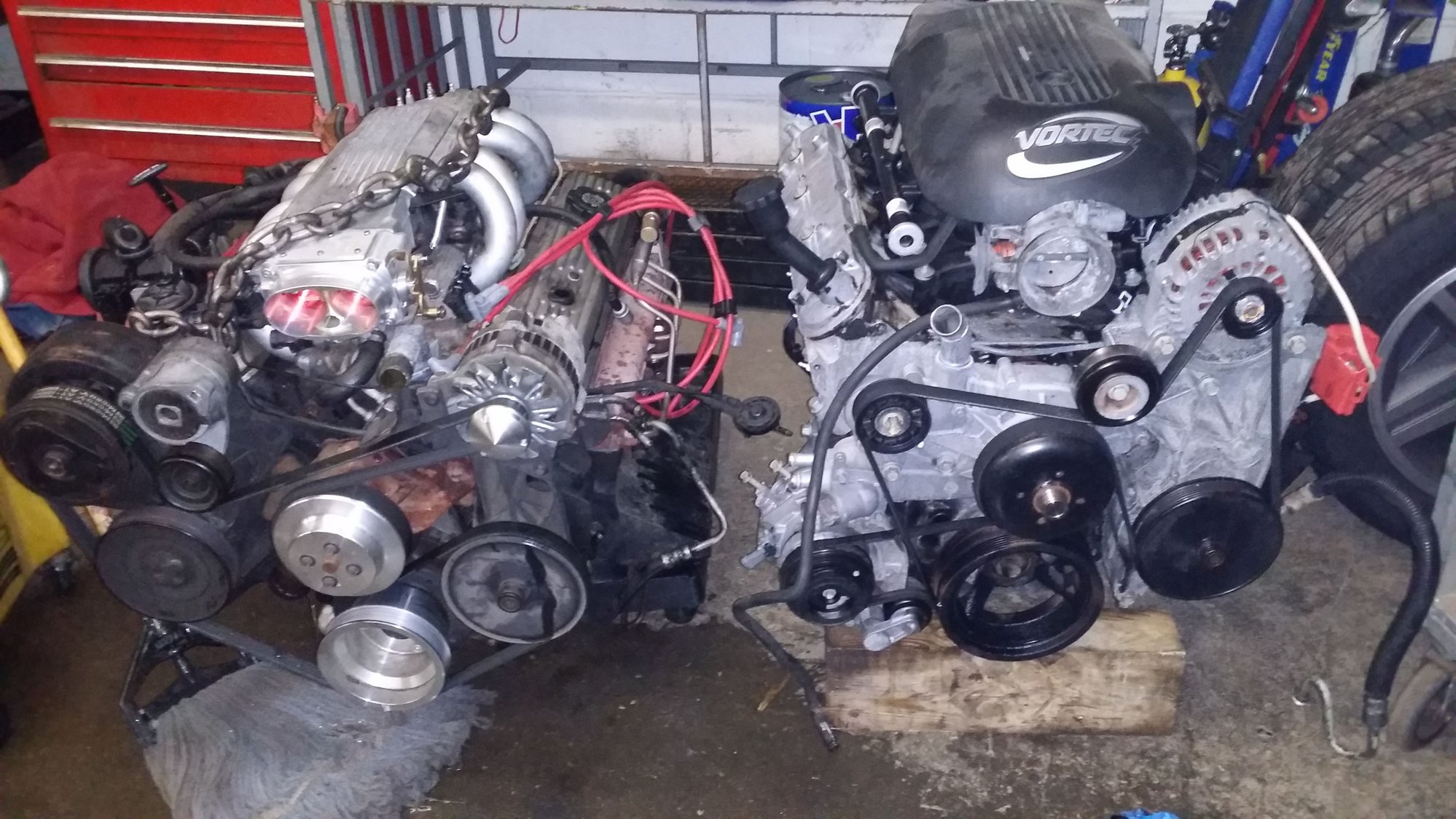

HERE IS WHAT IT LOOKED LIKE. GOOD BYE 305 TPI

Motor and Transmission are out obviously lol

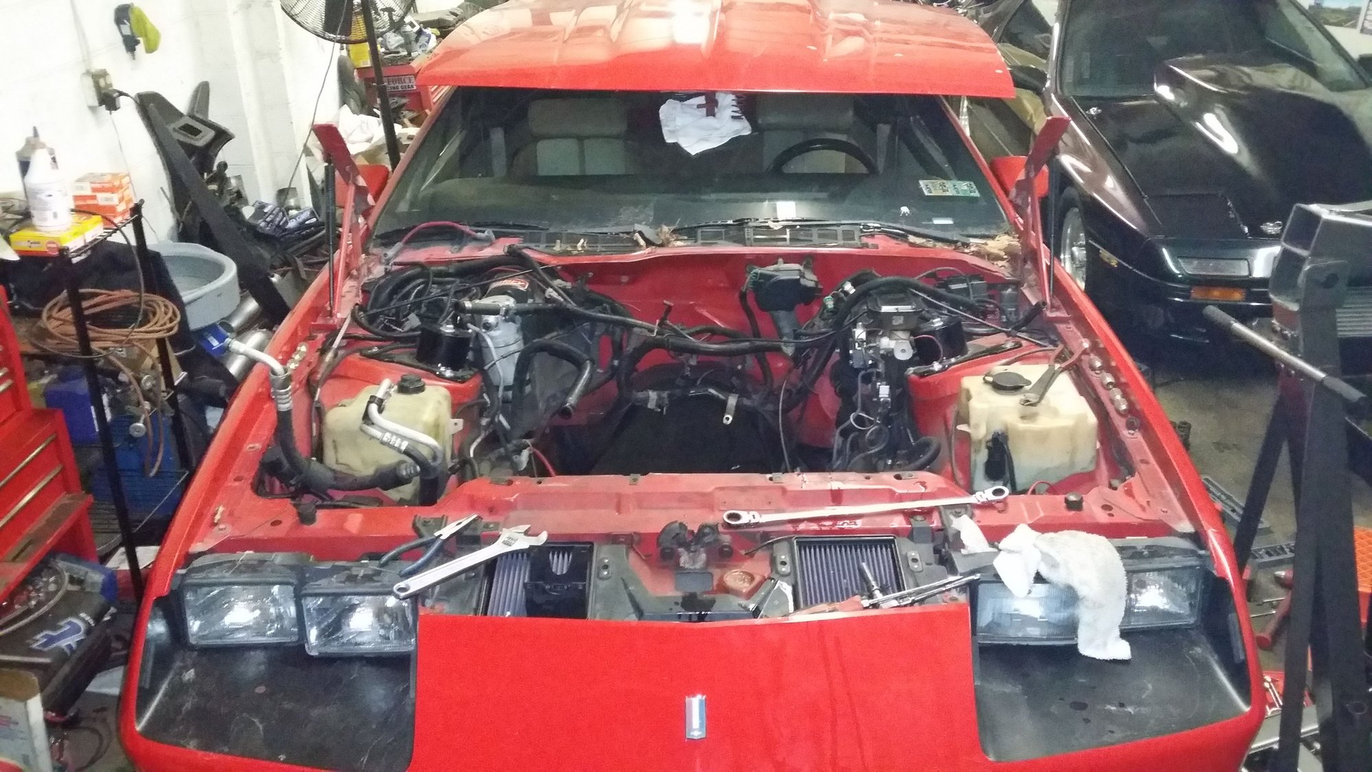

Here is what it looked like before I cleaned it up in there

Here it is cleaned up in there. I would of loved to have the time and money to have it painted in the engine bay. I didn't want to spray can it for the reason of I will get a body shop to spray it in there eventually
