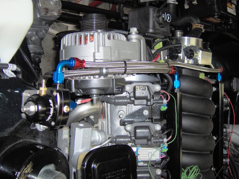

Lonnie,
Do you have a close-up of the driver's strut tower - how you mounted the fuel reg?

Re: Corvette accessories... whats the verdict?
I'll look... I like the location, but it will interfere with a strut tower brace... an afterthought I now regret.
Found it.
